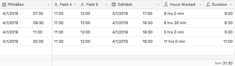

One option is to add another formula field that extracts the time data and presents it in a way such that Airtable will let you format the field as a duration. That way the column will summarize the durations correctly.
Here’s the formula I used:
((VALUE(LEFT({Hours Worked}, FIND(" hrs ", {Hours Worked}) -1), 2) * 60)
 + VALUE(MID({Hours Worked}, FIND(" hrs ", {Hours Worked}) + 5, 2))) * 60
Another option is to rework the original formula to output a duration-compatible number in the first place. You lose the “friendly” labeling, but it makes summing the values a breeze.

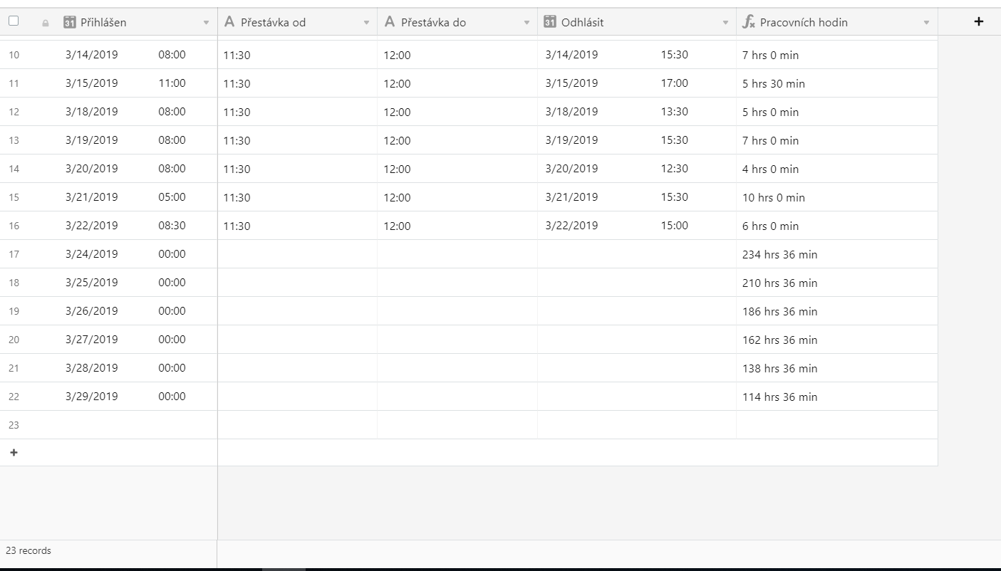

Thank you for your help, unfortunately it donst seem to work on mine.
this is what i get:
its seems to work in yours though, i apreciate your help
this is what i get:

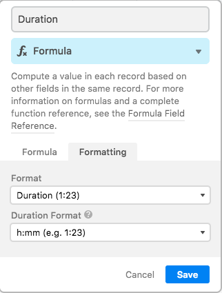

You have to open the Formatting tab when customizing the field. Change the format to Duration, and it will work.
  • April 4, 2019
it works now! thank you so much for the help!
