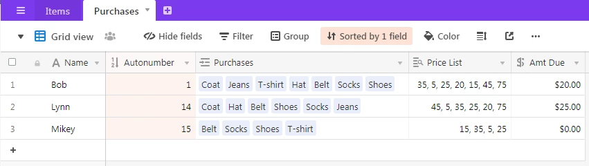

Hi @AlliAlosa, @Justin_Barrett - thought I’d have a look at this one. I’m getting close to it (maybe you’ve got this far too?)
In this base, once you purchase more than 2 items, it removes the least valued item from the total:
Problems with this:
  1. I can only get it to remove the least valued item, not the two least valued items (if you purchase 4 items, for e.g.)
  2. I can only work it so that you can purchase each item once (is there a way around this?)
Not sure if this can be worked up to your exact requirements. Let me know if you can see a way!
JB

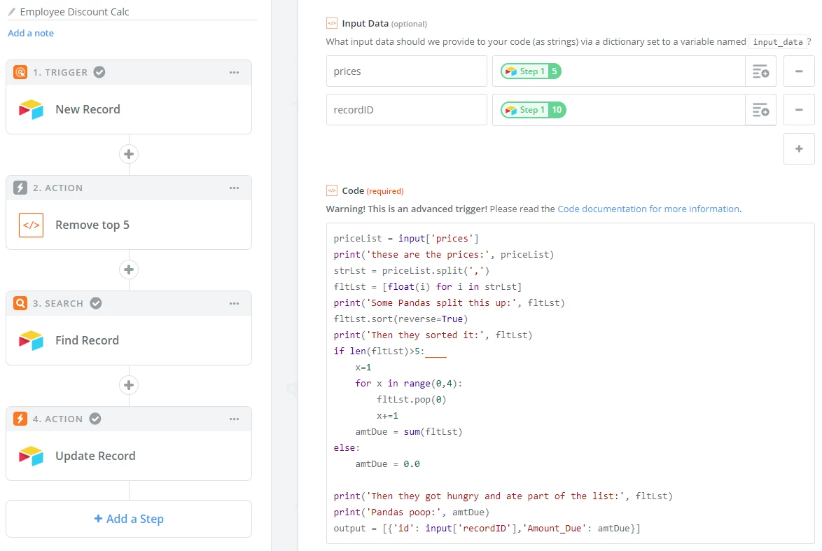

Well, i worked out how to do this with a Zap, but 2 downsides, 1) zap has more than 2 steps, so you need to get a paid plan for past the trial period, 2) only auto-runs every 5 minutes.

Not thats its complex, but in case you wanted to take a shortcut to meet the Pandas:
  priceList = input['prices']
    print('these are the prices:', priceList)
    strLst = priceList.split(',')
    fltLst = [float(i) for i in strLst]
    print('Some Pandas split this up:', fltLst)
    fltLst.sort(reverse=True)
    print('Then they sorted it:', fltLst)
    if len(fltLst)>5:
        x=1
        for x in range(0,4):
            fltLst.pop(0)
            x+=1
        amtDue = sum(fltLst)
    else:
        amtDue = 0.0
    print('Then they got hungry and ate part of the list:', fltLst)
    print('Pandas poop:', amtDue)
    output = [{'id': input['recordID'],'Amount_Due': amtDue}]
