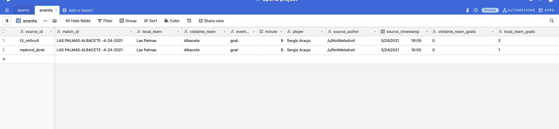

From an “events” table that hosts records from different events I need to determine the highest value in two columns grouping by an event_id.
So being events referring to football matches, the highest value would correspond to the last record with source_id 't3_nk5nz4'.
What I want to achieve
A single row with a coulmn that shows what which is winner team or it’s a draw.

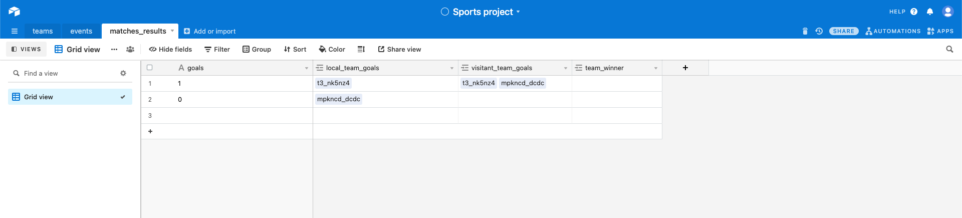

Hi! @Kamille_Parks thanks for the support.
I have a problem with linking fields.
What i want is know how to link the fields local_team_goals and visitant_team_goals to another table, something like i have in this table idea what i create:
Then i want to rollup them to add a formula and know which team was the winner. Something like:
So, in the example tables even i haven´t the fields linked right so again, what i don´t know and i want to know is how link my fields right.

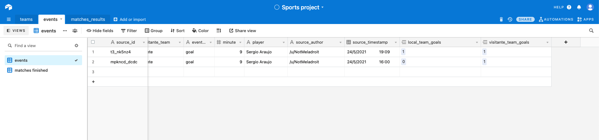

In the Events] table, the {local_team_goals} and {visitante_team_goals} fields should be Number-type fields not Single line text or Link to another record.

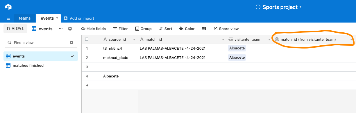

Oh sure, i made that table just as reference to give an idea of what i look for. In theory that’s exactly what i mean but the fields are not linked of a right way.
Then, if i follow the steps that you describe i get something like:
so, in orange is remarked the field that is created in the same table, now my question is how i could send that new fields linked to match_id that are created there to other table as the reference table.

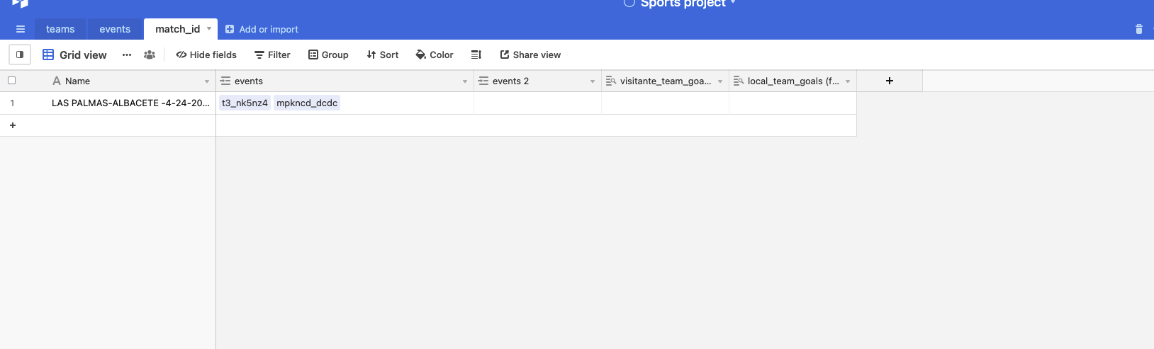

In your first screenshot you have two links to the Events table, you only need one. Make sure your two lookup fields are pulling from the {events} field not the redundant {events 2} field.
Your second screenshot doesn’t have a match_id table.
