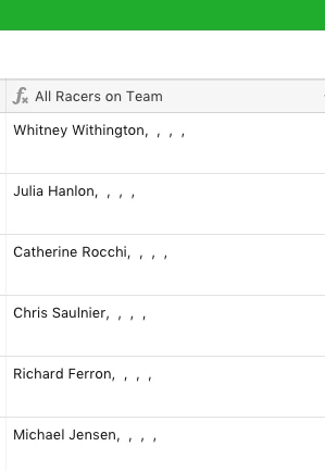

I’m having problems suppressing extraneous comma delimiters when trying to combine multiple fields into a single column of values separated by commas, but showing no comma if any of the combined fields are blank. I tried various combinations of this formula to no avail.
IF({Racer 1 Full Name},{Racer 1 Full Name})&IF({Racer 2 Full Name},", "&{Racer 2 Full Name})&IF({Racer 3 Full Name},", "&{Racer 3 Full Name})&IF({Racer 4 Full Name},", "&{Racer 4 Full Name})&IF({Racer 5 Full Name},", "&{Racer 5 Full Name})
The above formula yields the following output:
The above example is trying to place 1 to 5 names in a single field separated by commas, if the name field being combined is blank, there should be no comma separator. Note, there is always a Racer 1 name so no need to suppress on that field, just on Racers 2 through 5).

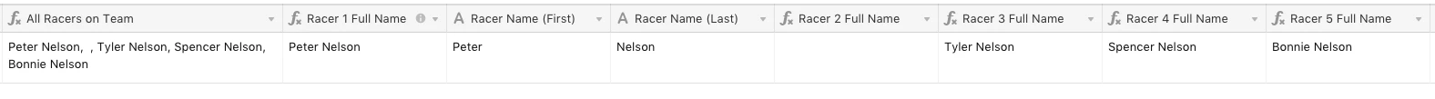

David, I modified by question and issue (above). Each name in the series I am trying to string together is formula field that calculates the Full Name as a combination of separate fields for First Name and Last Name. I would think the IF formula should work for that too but it’s not for me. Here’s an example of the output not suppressing the commas when the 2nd racer name is blank.
The reason your formula is catching the supposedly-empty fullname fields is because the space makes it non-empty. You could modify the name-combination formulas like so, only combining the names if the first name actually exists:
IF({Racer Name (First)}, {Racer Name (First)} & " " & {Racer Name (Last)})
If there’s no first name, then the combo field would truly be blank, and it wouldn’t be picked up by your longer formula.
