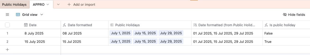

Hello, I have a JF table which contains dates of public holidays and an APPRO table which contains a date field. I can't test if the date field in the APPRO table is a public holiday. Does anyone have a solution?
EDITED: Ignore this, ​@Alexey_Gusev ‘s solution below is much better

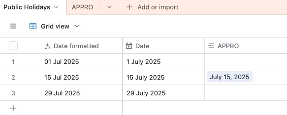

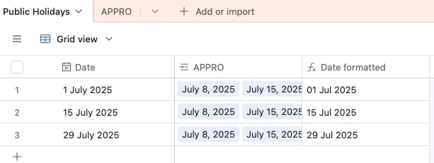

Hmm, I think you’re going to need to link all of your public holiday records to each of the records in APPRO, and then use a formula field to check whether it’s the same date.  I’ve set it up here for you to check out
FIND(
{Date formatted},
{Date formatted (from Public Holidays)} & ''
'True',
'False'

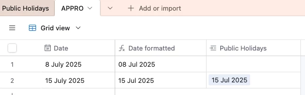

Note that a bit easier way is to make Date formatted a primary field in “Holidays” and then in APPRO just clean linked field, copy-paste ‘Data Formatted” in it and that’s all - records with links are holidays.
Oooh yeah, you’re right, that’s a lot cleaner and I’ve set it up here
  • July 18, 2025
Hello, I did this in the end, thank you
