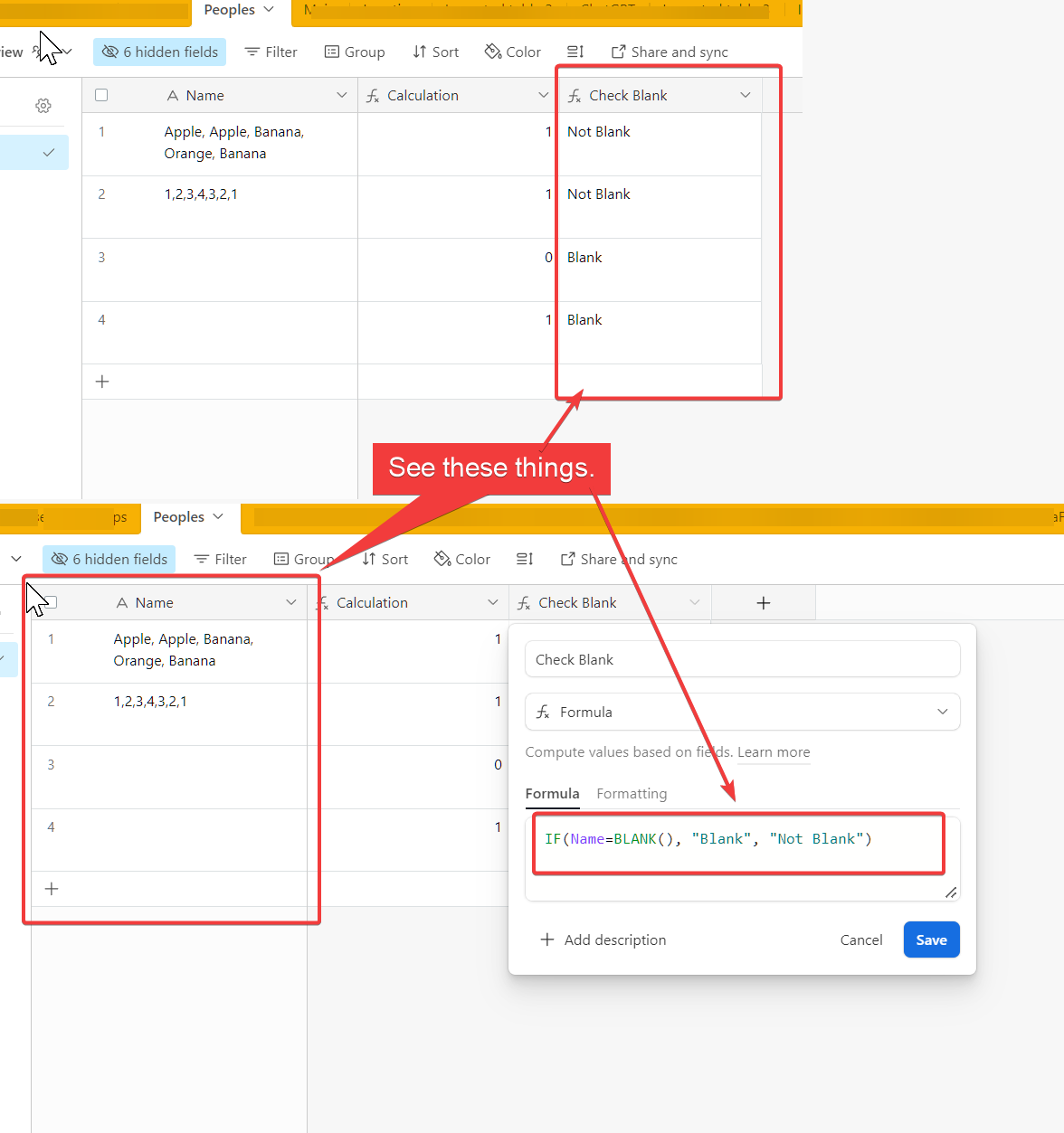

Hello @Karl_at_Easy_La
I think this will be a basic formula for it.
IF(Name=BLANK(), "Blank", "Not Blank")
Check the Image as well.
I hope it helps.
