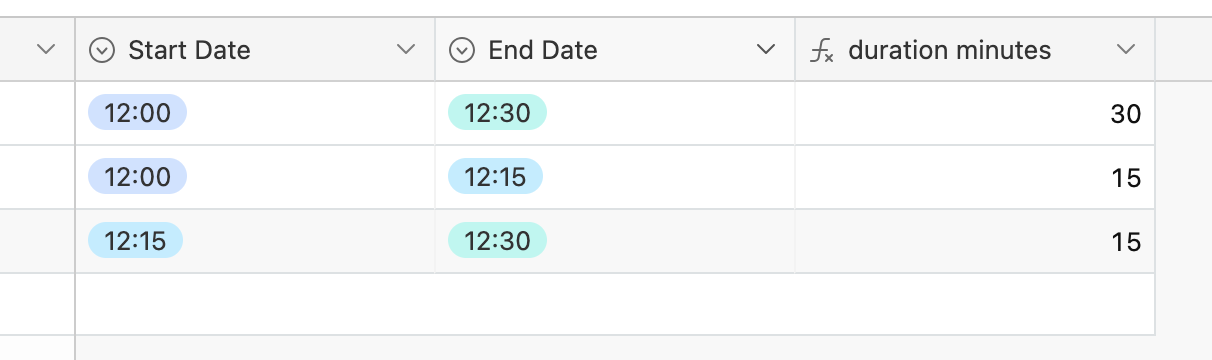

Hi Peter - this can be done with a formula. It may look like this:
DATETIME_DIFF(
DATETIME_PARSE({End Date} ,'HH:mm'),
DATETIME_PARSE({Start Date},'HH:mm'),
'minutes')
Here is how it works in action:
DATETIME_DIFF(
'minutes')

@preshetin Thank you!! Now it looks so simple 🙂
