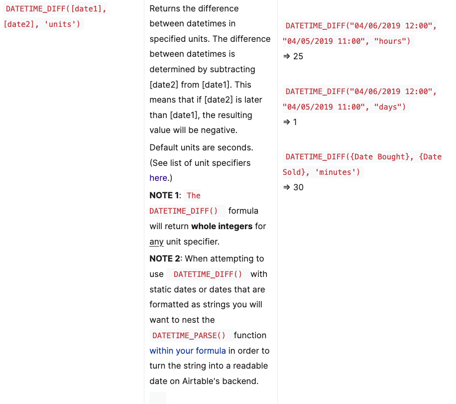

Try using `DATETIME_DIFF()` instead? Formula field reference
Perfect! I used the following and it worked great:
DATETIME_DIFF(Start,NOW(),'hours')
