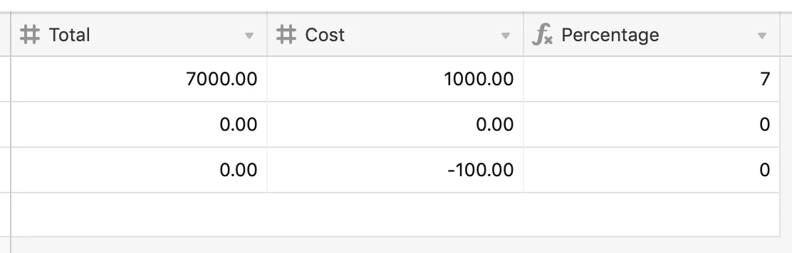

Hi @Emma_MH - try this:
IF(Cost > 0, Total/Cost, 0)
Strictly speaking to get a total as a percentage of cost I would do:
IF(Cost > 0, Total*100/Cost, 0)
I think the problem you have is that if Total and Cost are numbers, you are turning them into strings with the quotes.

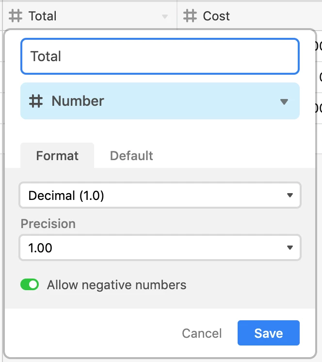

Total and Cost are decimal numbers, allowing negatives:

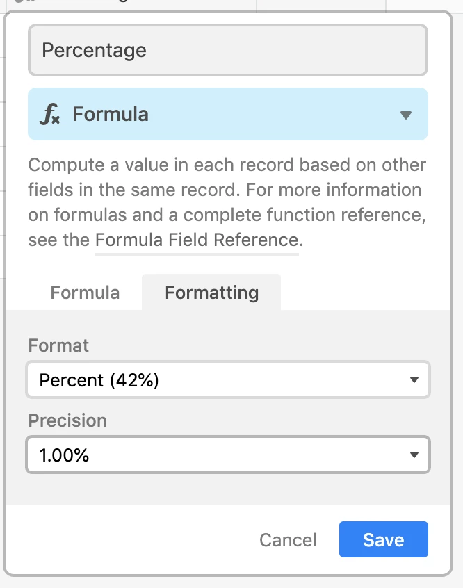

Also you can format the percentage column as a percentage:

Thank you! That worked!
