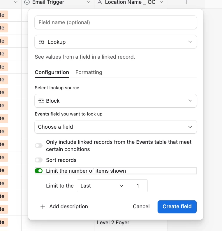

I think I'm following -
basically assigning two instructors and want a look up field for the emails both instructors in a two separate field?
- since its only 2 you could, set the look up to limit # of items shown (one first item, the other last item shown) but you want to ensure you place them in the correct order each time you needed to link them
- i've faced similar challenges when assigning primary / secondary contacts to certain events. Tagging each of them on their linked record doesn't quite work because its varies (they may have more than 1 events but may want to delegate responsibilities to another primary contact) . To make it streamlined from the team we decided to just implement 2 fields linked to contact records for this purpose.

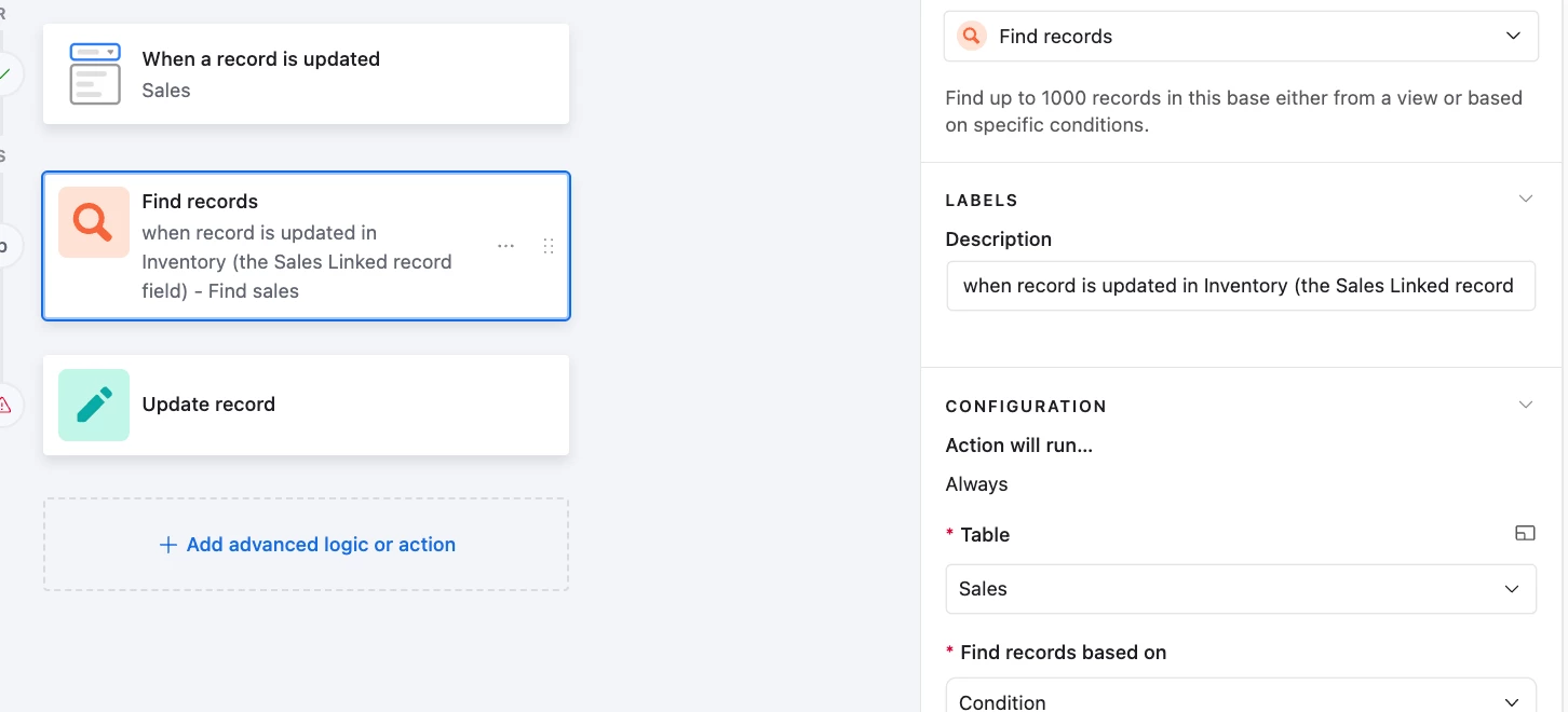

Yes there is ! If I'm understanding your objective correctly you should be able to place a 'find records' action in the middle of the your trigger and end action
Hope this helps!

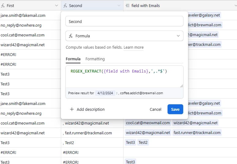

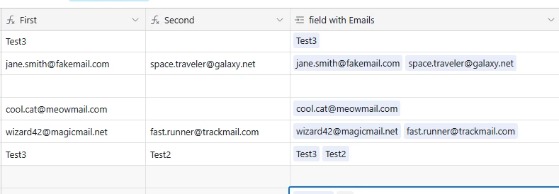

Alexey_Gusev
Forum|alt.badge.img+25
Another type of solution
First is good, second needs to remove comma.
Added brackets to clarify a part that must be shown .
REGEX_EXTRACT({field with Emails},',(.*$)')
Also, added 'emptiness check' to fix #ERRORs
IF({field with Emails}, REGEX_EXTRACT({field with Emails},'^[^,]+') )
it's not enough for second, we need to check for comma:
IF(FIND(',',{field with Emails}), REGEX_EXTRACT({field with Emails},',(.*$)') )
Now it's OK
