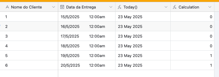

Hmm as a data point, your formula worked fine for me.  If I were you I’d try:
  1. Creating a new base, replicating it and testing it
  2. If that doesn’t work, create a new connection and link it to the new base and test it
Just so you can rule out any weird permissions / auth issues you know what I mean
