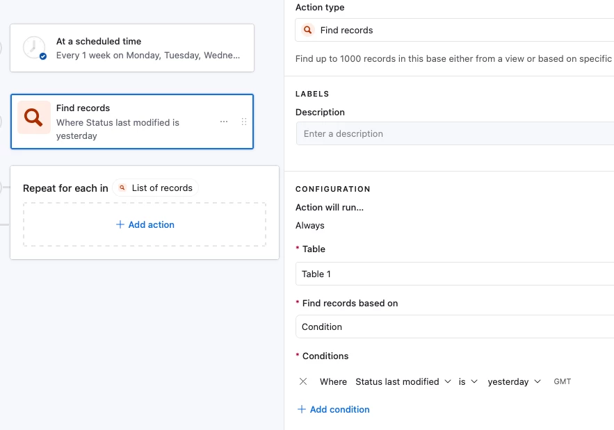

Hmm, what if you used an ‘At scheduled time’ trigger instead? I’ve set it up here for you to check out
The idea would be to create a ‘Last modified time’ field that looked at the ‘Status’ field:
And then we’d have an automation that would trigger at 9am on every weekday, and it would look for all the records where the Status was modified yesterday and carry out the action you wanted:

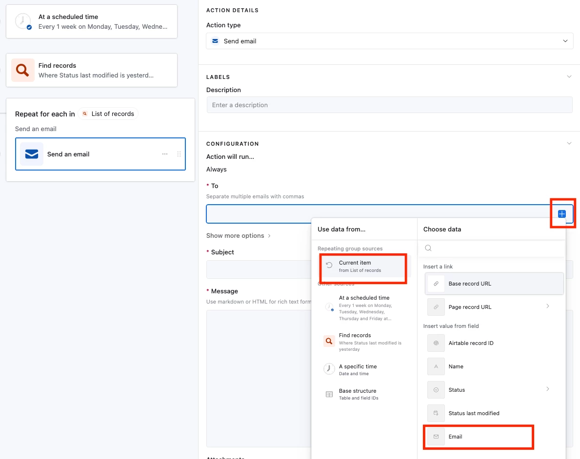

Thanks. When configuring the email automation how can I ensure it sends to the correct email addresses?
Hey ​@Jwatson1,
I believe  this is what you are looking for:

Specifically min 2:00 from the video above probably!
I’m assuming the records have the email addresses needed?  If so, you would use the ‘Email’ field value from ‘Current item’ like so:
