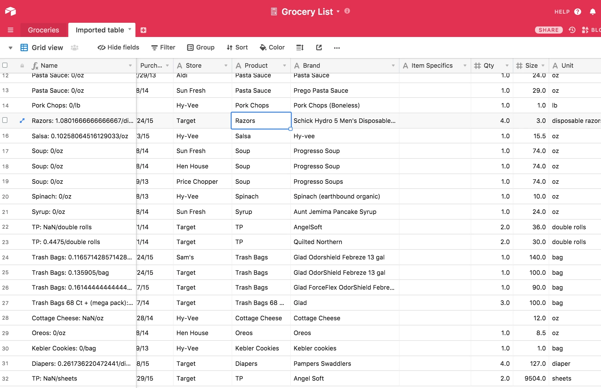

Hi W Vann Hall! Thanks for your replies on a few questions I’ve had. Sorry for not acknowledging them yet–I’ve got 3 little ones, so my concentration times are limited! Anyway, I’m trying to process your suggestion and struggling to understand, as I’ve tried using Value() with continued error messages. :frowning: I’m attaching a screenshot below, in which I attempted to have the name field reference a currency field and a unit type field. Ideally it would say, “TP: $0.45/double rolls.” When I tried to adjust the number by starting with a VALUE function, it gave me error messages. Any ideas how to overcome this and limit it to two places?

To answer your last question first, it turns out formatting currency fields converted to strings can be a surprisingly complex chore…
To answer your first question, I dunno: Could you PM me a link to your base so I can see what might be causing your errors. To do so, select ‘Share’ > ‘Create a shared link to the whole base’ > ‘Private read-only link’, and message me the generated URL.
In the meantime, often a NaN — ‘not a number’ — result indicates one is trying to solve a formula in which one or more of the expressions (frequently the divisor) is null. Check to make sure all the components of your price-generating formula exist; that is, if {Price} is defined as {Cost}/{Quantity} and is returning NaN, make sure both {Cost} and {Quantity} have numeric values assigned to them.
