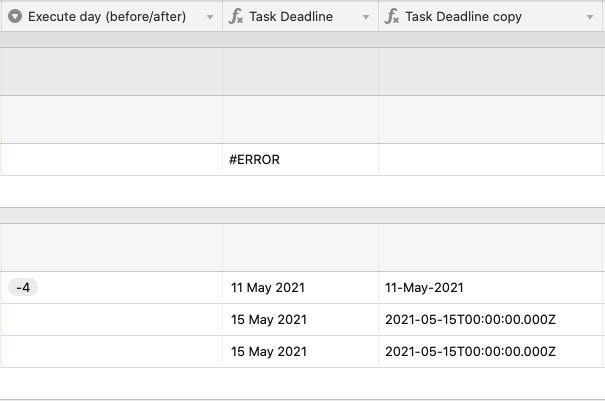

I need to use DATETIME_FORMAT two times in my IF formula, otherwise it won’t show the date correcty.

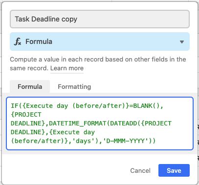

The current formula that I am using is:
IF({Execute day (before/after)}=BLANK(),{PROJECT DEADLINE},DATETIME_FORMAT(DATEADD({PROJECT DEADLINE},{Execute day (before/after)},‘days’),‘D-MMM-YYYY’))
Can’t figure out where I am supposed to add the first DATETIME_FORMAT formula.
Any suggestions would be much appreciated!

Looking at your formula I believe you are missing the DATETIME_FORMAT() for the Project deadline in the “true” evaluation of your IF() statement.
I believe the formula should look like the following:
    DATETIME_FORMAT({PROJECT DEADLINE}, ‘D-MMM-YYYY’),
Let me know if I can help provide any more information, and if this helped answer your question please mark it as the solution :white_check_mark: .
