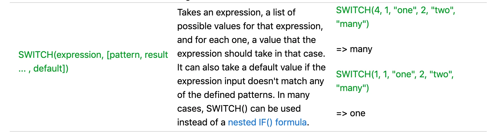

I’m sure you have many other cases which may not be reflected in this proposal, but I’d suggest starting with a SWITCH() function inside a conditional and see if that meets your needs:
Formula field reference
For an overview of formula fields, please refer to the Guide to Formula, Lookup, Count, and Rollup fields. Formulas may involve functions, numeric operations, logical operations, and text operation...
   {Client Name} = "ABC",
   SWITCH(
      Currency,
      "USD", "$",
      "GBP", "£"
   {Customer Code}
