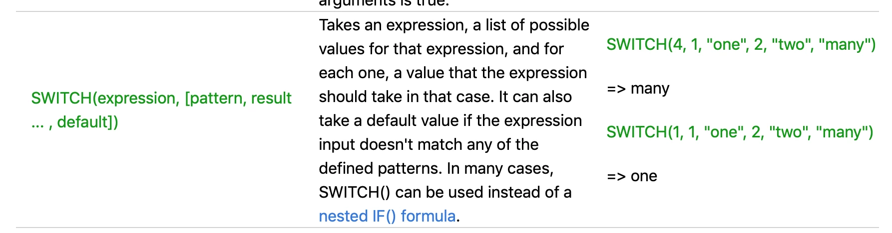

Since each condition you need to check is referencing the same field (Room), I’d suggest using a SWITCH() function for this:
It would look something like this:
SWITCH(
   {Room},
   "HPL Program Room", "Address 1",
   "Room A", "Address 2",
   "Room C", "Address 3",
   "Room B", "Address 2"
and you can continue adding your list of "Room", "Address" combinations inside that function. Make sure to add a comma after each address except the very last one in the list.

Hi @Annie_Tillmann - you can use a nested IF formula, although a SWITCH formula might work better in this case:
SWITCH(Room,
 'Room 1', 'Address 1',
'Room 2', Address 2'
JB

@Niels_Schneider, you can include a “default” value as the final argument to a SWITCH() function. The function will fall back to the “default” value if no match is made in the SWITCH() function. So an example would look like this:
SWITCH(
   {Room},
   "Room B", "Address 2",
   "Default value"
