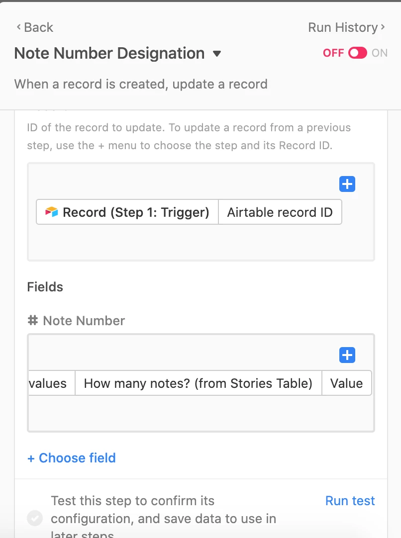

Thanks @Rohit_Gandrakota ! I have a question for you, but first, for anyone following this thread, I want to rewind for a second and share my solution for numbering notes via Automation (something Rohit suggested).
  1. First, I made a Count field that counts the number of notes in the “Story Note” field, and created a lookup for it in the Notes table.
  2. Next, I created an automation that fires whenever a new record is created in the Notes table.
  3. The automation sets the note number to whatever value the count field has when the note comes in:
@Rohit_Gandrakota , where I’m lost is with retroactively assigning numbers to notes using the view in the notes table. Here, you’re suggesting that note number be set to max note number +1 in the view where any note has a blank integer value, but if all notes previous to the automation all have blank values, wouldn’t that set all of the notes to “1”? I ask because in reality, I have a couple hundred notes in my database. I can live with not being able to number these retroactively, but maybe there’s another way or I’m missing something?
And then just to close the loop here, it sounds like with this set up, I can then create a rollup in the Stories tab that displays note text for all note records whose note # value is less than or equal to 2?

You are right, this doesn’t work retroactively. But for old notes, you can manually update the note number. Once you do that, what you suggest at the end to filter for note number < 2 should work.
If you absolutely want to do this retroactively, you can add record created time for notes. You can then setup automation for only the earliest created record.
In this solution, note table will have created time.
Story table will have a rollup field with earliest created time among all notes with note number blank or not assigned.
Notes table will have a lookup field from story table which displays the earliest created time.
Note table will have a new filed, call it check, with formula of earliest time matches created time, then 1 otherwise 0.
Create a view to filter only for check field is 1.
This will only filter all notes with earliest creation time for a particular story.
Now your current automation should work to assign note number.
Once note number is assigned, the next earliest created note will be filtered in the above view for which automation applies.
But I highly recommend doing the retroactive stuff manually and staying with your current design.
This seems too complex and I always prefer simpler solutions especially in cases where manual work is one time activity.
Either way, let me know what you end up picking.
