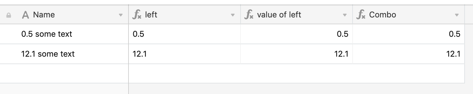

Hi @Jason_Calaiaro - your formula works fine for me:
Combo field is:
VALUE(LEFT(Name, 4))

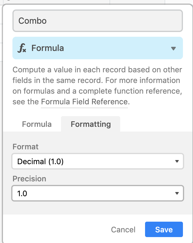

Make sure the formatting on the field is set to decimal
