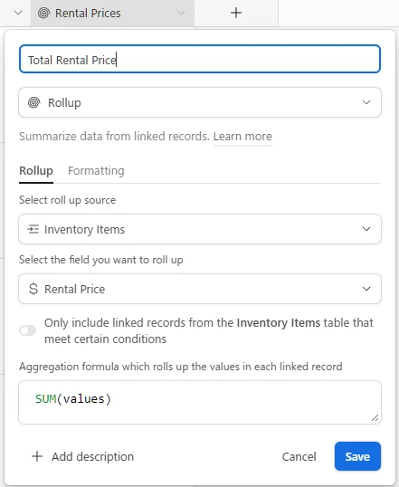

If they are linked, then the Rollup field can be used.

Add a Rollup field to "Home Staging Projects" table
 Can you set it up like this?

OMG IT WORKED!!!! THANK YOU SO MUCH! I wouldn't have ever thought of that, and I've watched several Youtube videos to figure this out. I really appreciate it so much.
