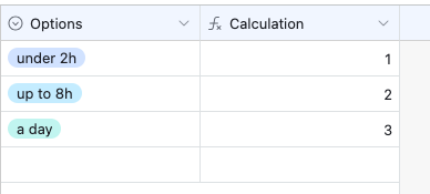

Try a SWITCH:
SWITCH( Options, "under 2h", 1, "up to 8h", 2, "a day", 3 )

Thank you! This worked!
