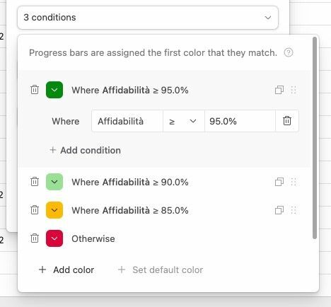

Hi everyone,
I have an issue with the color formatting for Formula Feilds displayed as progress bars, it seems buggy:
With decimal percentages the conditions are not recognized properly, I have the following conditions on a field
but the results are unfortunately wrong for values that are near the "breakpoints".
Any suggestions?
Thanks
Best answer by BillH
Thanks @Sho and @BillH for your reply.
@BillH I'm not sure about how to go to do that. Can you please provide the formula you input in the new field?
My field is a simple x/y operation, formatted as percentage and displayed as bar.
Thanks
In my sample the formula for the percent field (named percent) is similar,
Done/Target
For the bar it just
percent-.0049

Hi @loewe,
I've tried it, seem like color condition apparently can only handle integers.
It is a regret.
BillH
Forum|alt.badge.img+24
  • October 27, 2023
Seems like I'm nitpicking, but it's a rounding limitation rather than an integer limitation (49% is actually .49 not 49).  Taking that into consideration, if you can display the percent figure separate from the bar, then adjust the formula for the bar to something like percent-.0049 you should get the desired color.  In the sample below 50% is the cutoff for the color changing from red to yellow, so the original on the left is incorrect, the adjustment on the right is correct.
Thanks
Done/Target
For the bar it just
percent-.0049
  • October 28, 2023
Done/Target
For the bar it just
percent-.0049
I was confused and deleted my earlier post...
I see, so you mean subtract 0.0049
Excellent solution!
