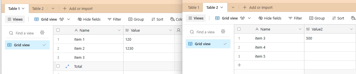

I have two tables, Table 1 and Table 2, with different fields. When a specific record is populated in Table 2, I want the values of some of its fields to automatically appear in a corresponding record in Table 1where the cells were initially empty,  based on the primary fields of both tables, I’m calculating a total in Table 1 based on entries into records in several tables and need to have the total in Table1  automatically updated whenever the values change in the other tables. What is the best way to achieve this? IOW, what is the equivalent of XLOOKUP or Index Match in Airtable?
Hmm, from your screenshot, I’d first recommend consolidating the data; instead of having two tables where you have items and values, it should all be in a single table

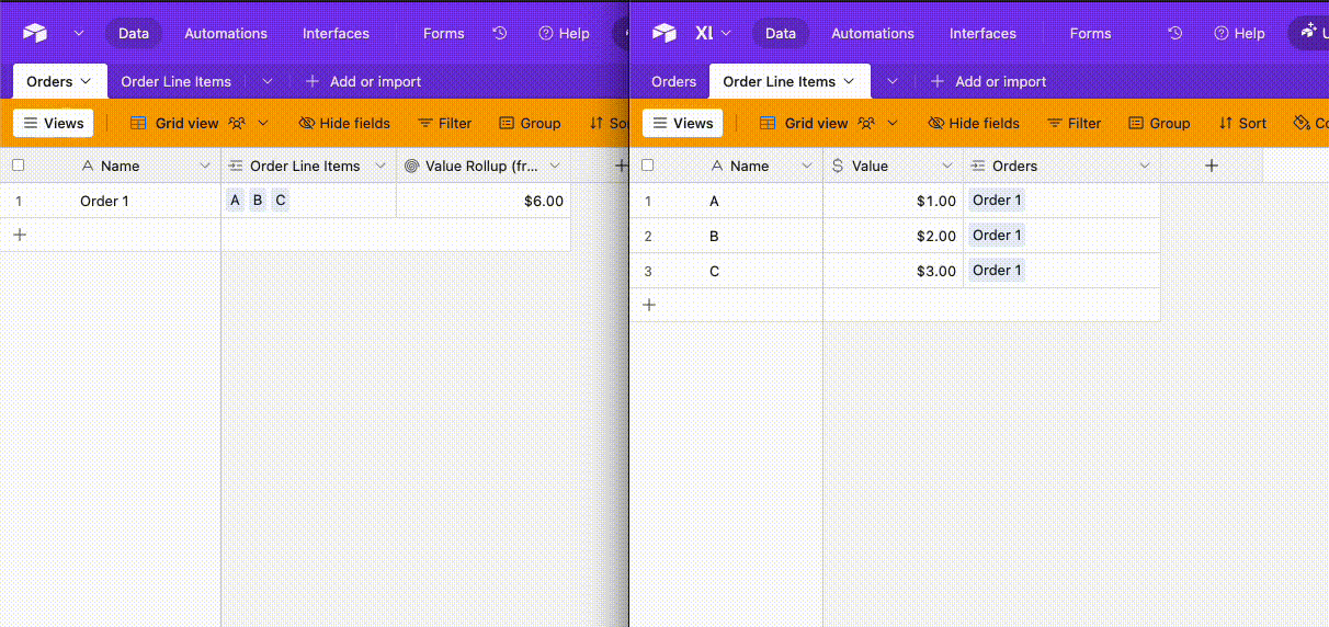

After that, I’d recommend creating a new table where each record represents a single grouping of your items, and then linking your items to that grouping record, and then you’d use a rollup like in the previous example

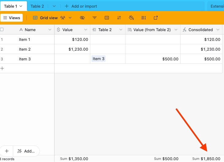

With your current data structure, you’d need to:
  1. Create a linked field to Table 2
  2. Link the records together
  3. Create a lookup field to pull the value over
  4. Create a formula field to consolidate the values
  5. View the total sum like so:
    1.
This is fine if you’re doing something quick and dirty but generally not recommended, and you can find it set up here

You’d generally accomplish this via linked records and rollup fields:
How we set up the links between the records is going to depend heavily on your workflow though, and it could either be done manually upfront, or accomplished via an automation.  If you could provide some screenshots of your tables and talk a bit about what your workflow is that’d be helpful!

Thank you so much! I need the 500 to appear in Table 1, and the total to be calculated in the total row/record

To solve for this, you create a linked record field between the two tables, and then add a lookup field in table 1 that displays the Value 2 field (which can be done while you’re adding the linked record field tbh). You’ll then have both a Value Field and a Value2 field from Table 2. Finally you add a formula field that computes the numbers, basically “ {Value} + {Value2} “ and call that field “Total”.
I might suggest making those Value fields either number or currency fields instead of long text to ensure nothing goes wonky later, but just tested this and it works fine as is.
