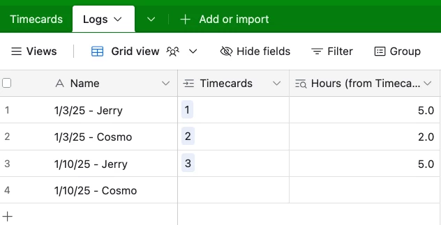

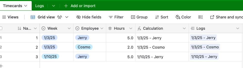

Assuming you want the end result to be an Interface where each timecard the employee has missed is available for them to update, then the quickest way would be to just write a script for this really
If a script isn't an option, you could try:
1. Creating a new table where you create one record per week of the year per employee (i.e. if you have 10 employees you'd end up with 520 records), where each record represented a single week and a single year
  - Let's call this table 'Logs'
2. Make the primary field of this table a combination of the date interval and employee name, e.g. "1/3/25 - Jerry"
3. In your main data table (let's call this 'Timecards'), create a linked field to 'Logs'
4. In Timecards, create a formula field that outputs the same value as step 2, i.e. "1/3/25 - Jerry"
5. In Timecards, click the field header of the formula field from step 4, and then hit CTRL/CMD+C
6. In Timecards, click the field header of the linked field to 'Logs', and then hit CTRL/CMD+V
  - This should link everything up appropriately
7. In Logs, any record that doesn't have a populated linked field will represent a missed week for that Employee
