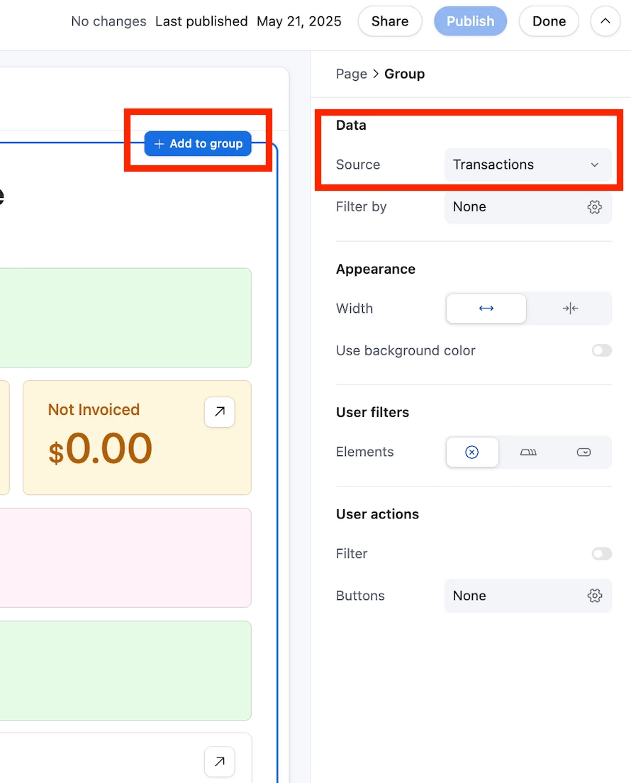

Hey ​@Limi!
Dashboard is actually one of the few exceptions to “an interface can only pull from one base”!
How dashboard pages are setup is they can have multiple Groups, where each group can have its own Source table -as shown on screenshot below. However, you cannot have data from multiple tables under one unique group.
Hope this helps!!
Feel free to reach out if you need any help setting this up.

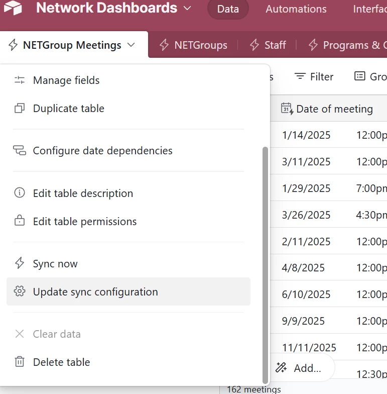

@ScottWorld can you clarify how to do this on the Teams plan? After trying to do this for 30 minutes and i gave up and realized it’s only open to Business/Enterprise.

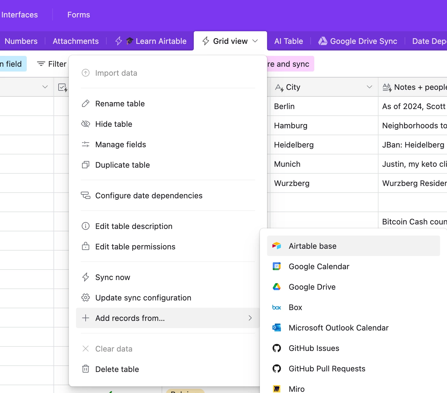

  • May 29, 2025
On your “destination sync table”, click on the little down arrow and choose “Add Records From… Airtable Base”.
See screenshot below.

@ScottWorld - That’s what i was trying to do… the “add records from” doesnt exist for me 🤔

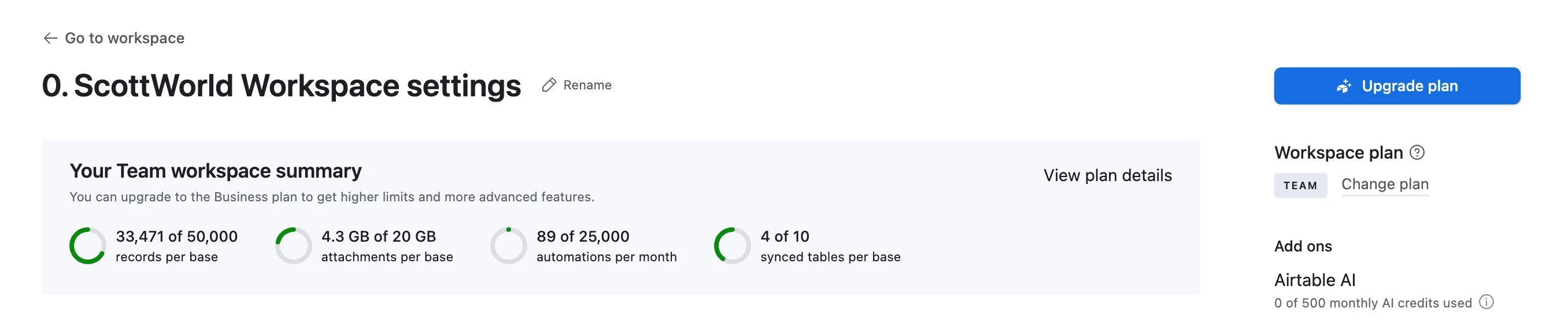

  • May 30, 2025
Wow, that’s very strange!
Maybe there really IS the restriction in place that only Business Plans and Enterprise Plans can add multiple sources to a destination table?
But what’s strange about this is that I’m on a Teams Plan, and I can add multiple sources!
See attached screenshot below of my workspace. Very weird.
