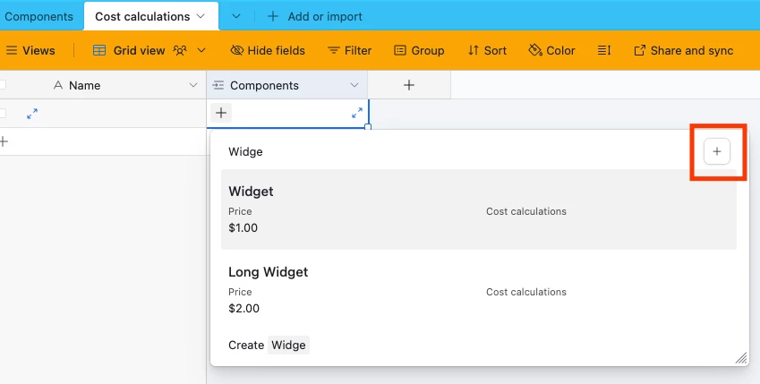

Assuming your data looks like this:
Then when your users are selecting the components from another table this is what they’d see:
And they’d need to click that + icon to add a new component
Them being unable to find a component in this manner basically would indicate that it doesn’t exist and they’d need to create it
