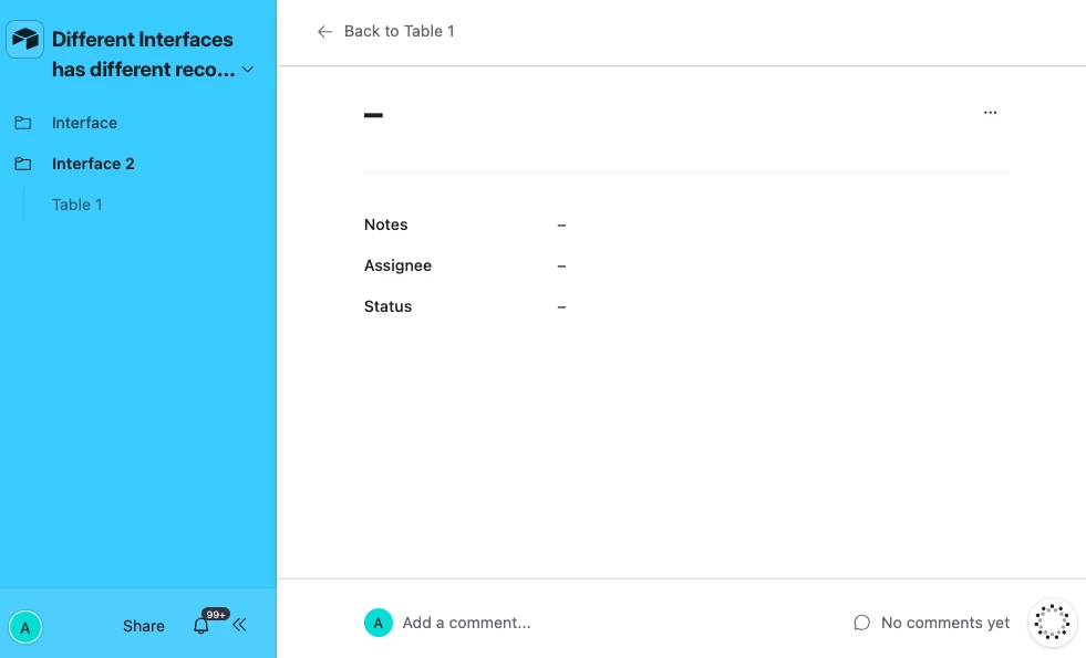

Depends on what Interface Layout you’re using I’m afraid.  Assuming we’re talking about a Record Detail, if you use the full screen version of that layout the Record ID gets used in the URL if that helps?
e.g. the following two URLs point at the same record in two different Record Detail Interfaces
https://airtable.com/appbs7SNL6vqXkB9L/pagT49DSTsEqO0na1/rec9x3xcA7aUooZUp/home=pagVIE4COa6gpFRdt
https://airtable.com/appbs7SNL6vqXkB9L/pagXhWGuZT0Wi6cPD/rec9x3xcA7aUooZUp?home=pag4J7U9WDBPZvEhV

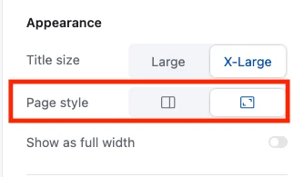

And here’s what I mean by a full screen layout:

Ah that’s not how you would share it.  The steps for setting this up are:
  1. Set the Dev Interface layout to use a full page record detail
  2. Open any record in that layout and copy the url from the full page detail
  3. Create a new formula field that rebuilds that url dynamically by swapping out the record ID in the copied url with record_id().  Your end product will look like something like this, with the app and page IDs being different of course:
    1. 'https://airtable.com/appbs7SNL6vqXkB9L/pagXhWGuZT0Wi6cPD/' & RECORD_ID() & '?home=pag4J7U9WDBPZvEhV'
