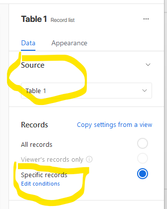

You can duplicate an interface page. But if you want to change the underlying table, you will have to manually change the source for each field individually. Select the record picker element, and the in the "Data" panel on the right side, change the source and the filtering . All of the existing fields will look broken. Go to each field and in the "Data" panel on the right side, change the source.
Thanks!  That must have been how I did it before, and just forgot.  Boy, it'd be nice if there were a global option to change.  But this should do what I need.
