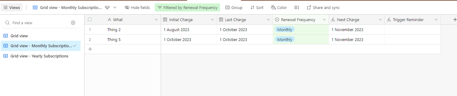

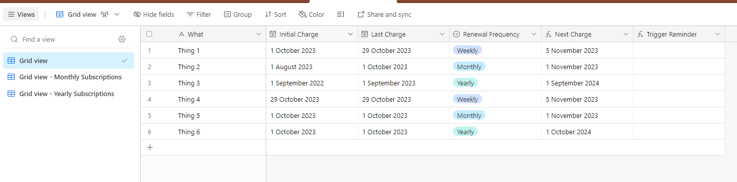

Hey @pascalm I'd recommend you save each filter as it's own view. That way you can quickly refer back to it when you need it, without having to mess around with the filter conditions each time you want to review your data.
Like this. Unfiltered Data:
Filtered Data View:

Thanks for the response @Arthur_Tutt but I'm using Interfaces.
And, I actually do want to update all the filter conditions each time, I have too many fields that I may want to filter but at a particular time that it's not viable to create a view for each one of them.
