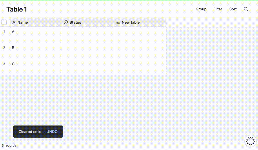

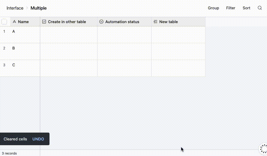

re: An automation that adds a new record into the relevant project based on a dropdown. The issue with both of these options is that I can’t do it on a ‘bulk’ basis. (...) Even if I select multiple records it just wont allow me to action them all at once.
Hm, if your automation’s set up to trigger from the dropdown being updated, this should be fine, right?
Is it that you don’t want to run the automation so many times?  If so, it may not be worth it unless you’re doing thousands of records at once as the workflow (depending on your Interface) could be confusing to your users.  For example if you’re using a Grid Interface, you’d do something like this:
The idea is to let your users select the records they want to create via the checkbox, and then trigger the automation via the select field
