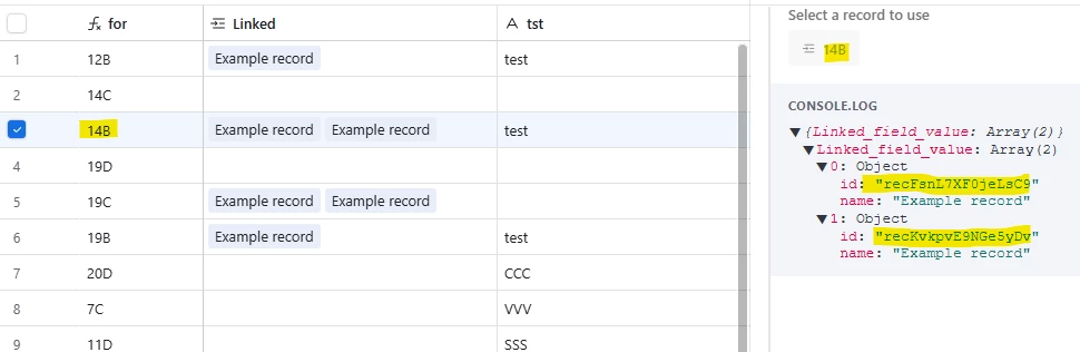

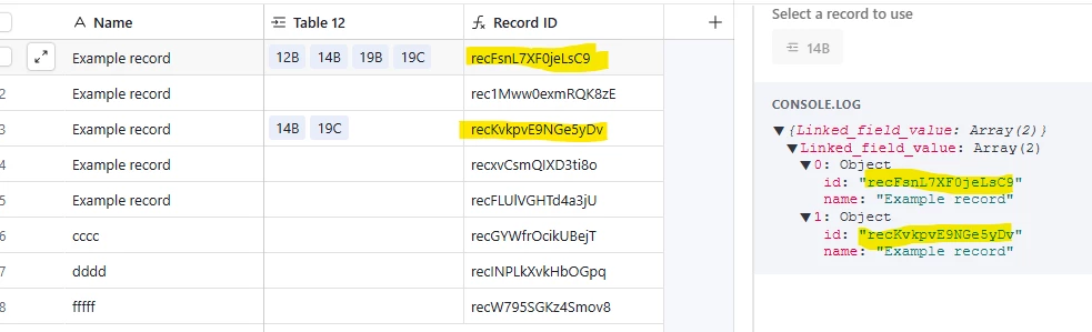

There are many ways to do that.
You should understand that each link in linked field exists in both tables.
To establish ‘one-to-many’ relation, it is better to act from ‘many side’
For example, when you can filter/group records which you have to link, just link one and then copy-paste link to others.
Also, link tied to exact record, by record ID.
So, if you have, for example unique User ID in the middle of both tables, you can temporary shift this ID in the primary field, switch to other table, use ID for link (just paste column of IDs to the linked field), then return the primary field back. Links will stay, just their ‘name’ will change.
That’s how it works.
