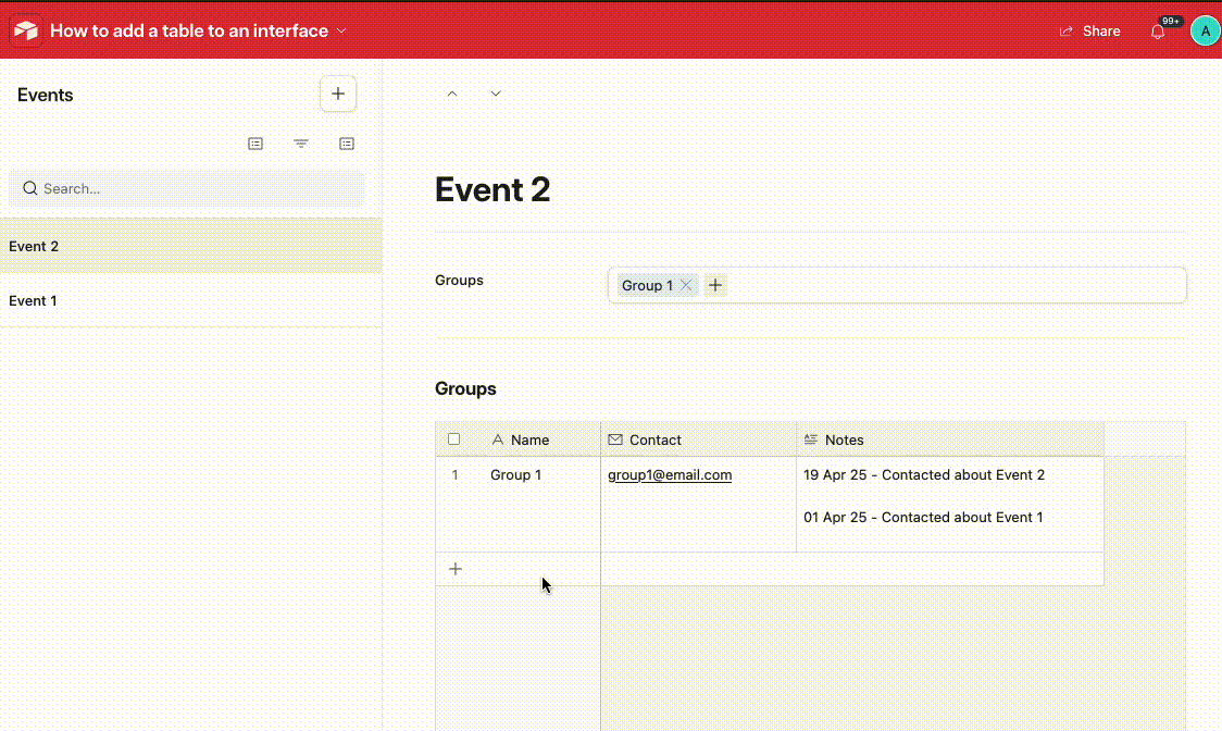

Hmm, are you trying to create a system to add Groups to an Event, and then contact each of them and then note down when you contacted them?  If so, you could try setting up your interface like this:

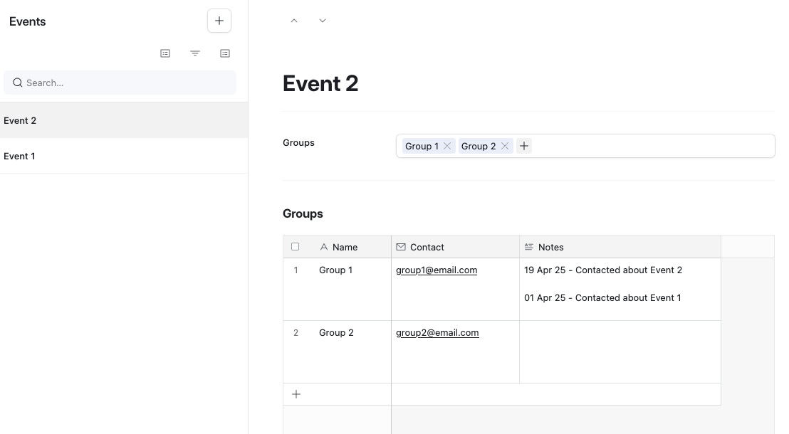

The first ‘Groups’ field lets you link groups to Event 2, and the second Groups field id set up as a view, so it works like this in practice:
And you can then key into the ‘Notes’ field when you contacted that group for that event
You could also set up a table where each record represents a single Group <> Event link and that’d be useful if you’re storing a lot of information about each unique link, but if it’s just the date of contact I’d just say use a text field to log it as freetext as it’s a lot simpler
