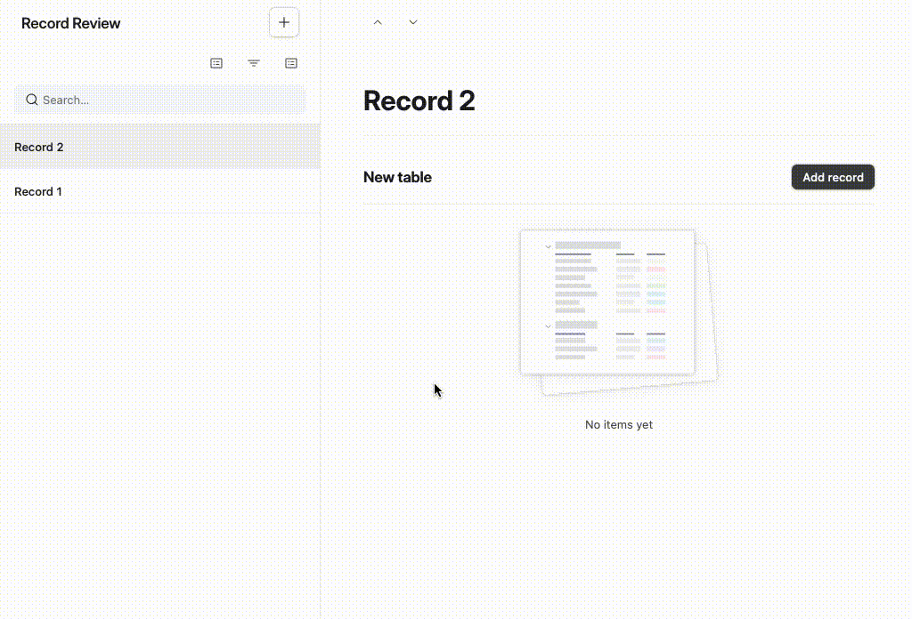

If you’re not looking for a form like UI, then a Record Review type interface could work, and I’ve set it up here for you to check out:

1. Create an interface for the parent table, show on it the linked record, allow the creation of new linked records through a form. Result: Not one form, but at least two forms. One for creating the “parent record” and within the parent record (once created) one for creating the linked record.

I was able to get something Good Enough™ by creating a new interface page of type blank, adding an editable record picker and a bunch of editable fields, finished by an “update” button.  I looked at using the Record Review interface page type, but then I have to add new records through a form, which -- as you both mention -- has the limitations of not being able to add sub-records.
The limitation with my solution is I still can’t add novel linked-linked-records -- e.g. if my top-level table is Concerts, which has 3 pieces from table Music, each of which has one compose from table Composers, then in my new Concerts interface I can add new Music records, but within that creation I’m in a form, so I can’t add novel Composers (only select from existing ones).  Not a dealbreaker for me for now.
