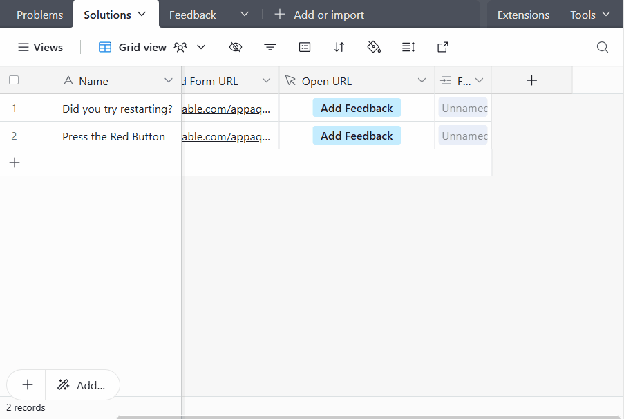

@opptcunysps , I agree that the architecture @Kenneth_Raghuna proposes is the best way to achieve this. I built a minimal demo of how to set this up.
Link to public interface 
This is how the backend looks like:
Also on this link you can copy the base I used for the setup.
