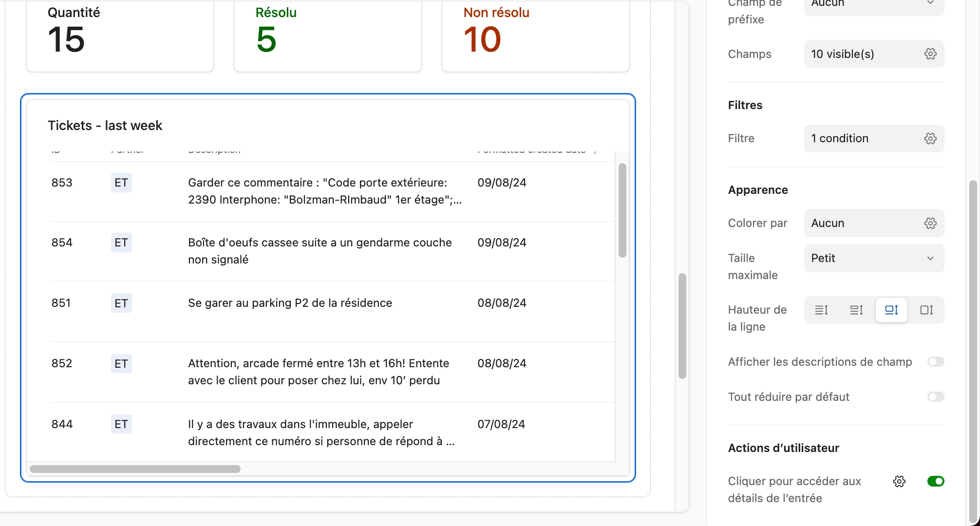

this might sound strange but I'm encoutering issues while wanting to allow users to edit or add new records to a list view in an interface.
Sometimes the toggle button to allow this just doesnt exist ... this is quite frustrating and I haven't figured out the way out of this.
Please help 🙂
See screenshot

Hello Mike thanks for responding
I've noted the group vs. list view. But still i don't have the same user actions possibilities to toggle. I only have the option ''Click into record details'' available. Please see screenshot.
Is there any general interface setting that i need to update ?

Hi ​@oVo_Team and ​@Mike_AutomaticN ! One year later I’m facing the same limitation here. Were you able to solve this?
When I add a list view inside a group in a dashboard page, it only displays the following User actions:
  • Edit records inline
  • Add/delete records inline
  • Click into record details

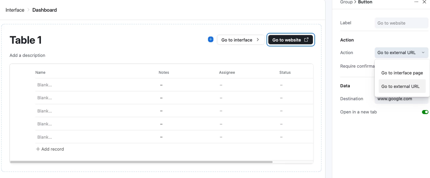

I believe if you’re using the Dashboard layout the only buttons you have access to are on the Group level and the actions are:
  1. Go to Interface page
  2. Go to external URL
May I know which button you’re trying to add and what layout you’re using?

Hi Adam ​@TheTimeSavingCo, Thanks for replying!
Yes, that’s it. My actual question was whether those two were the only buttons in the Dashboard layout.
I was trying to add a button like ‘Create new records through a form’. The solutions I thought of were:
  1. Adding a button with an external URL and linking to the form. But that’s far from ideal, since the form opens in a new tab or, even worse, redirects the page.
  2. Keeping the numbers, charts, and even the timeline on the Dashboard page, while adding a new List page in the interface to manage it.
But neither of these really achieve what we’re aiming for. Do you have any other suggestions?
Ahh, I just bite the bullet and do the open in new tab thing I’m afraid.  I take it you don’t want them creating records inline because you want to set required fields and stuff?
