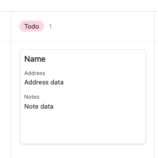

Yeah I don’t think we can do that at this time.  You could try using a Tampermonkey script to help with that?
Here’s the original:

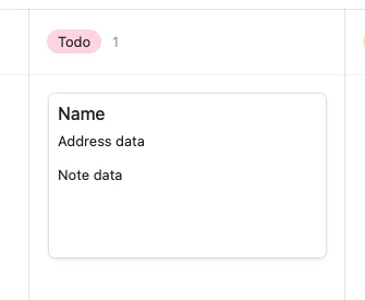

And here’s with the script:
The problem with the script is you’ll need to install it on each browser you’re using though and I’m not sure how feasible that is in your context
Here’s the script I threw together, let me know if you hit any weirdness and I’ll see what I can do!  You’ll need to change the ‘match’ value to your Interface’s URL (i.e. this bit: @match https://airtable.com/appREP113IoWVJoxC/pagPKD3eOzRxrwGnV)
