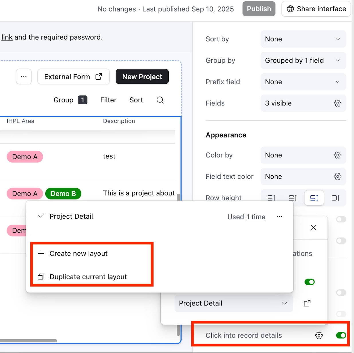

That should not be the case. To make sure we are talking about the same things:
Airtable calls “Interfaces” to the whole front end user experience.
However a given front en user experience can have multiple Interfaces, and each interface can have multiple Pages.
My understanding is that you have two different interfaces, each with a given List page layout. Right?
If so, the config (fields show, filters applied, edit inline allowed or not, etc) for the list itself should be completely independent. That is when discussing the list itself, which looks pretty much like a table.
However, the tricky part comes if you are talking about record detail pages. If you allowed clicking on a given record to expand its details, then that is where you will need to pay attention as you can (i) use the exact detail page for records from the same table (this is default, and probably your case), or (ii) use different detail pages for records from the same table depending on what page you are accessing that detail from.
Please see screenshot below for further context.
If you need any help setting this up, please make sure to grab a slot using this link and I’ll be happy to get this solved for you on a 5 min call!

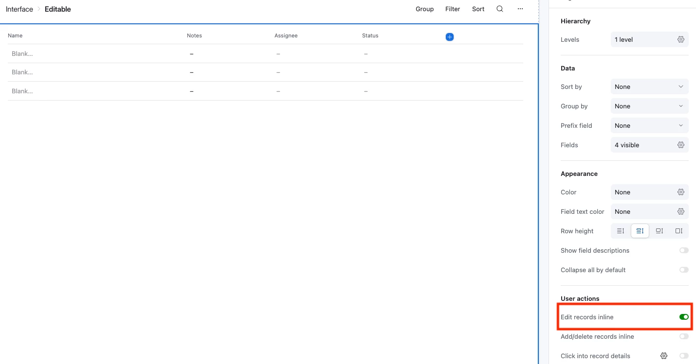

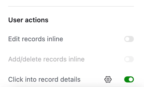

Hm, could you provide some screenshots of the two Interfaces and their setup options like the following screenshot please?
I just tested this out with the following toggle and it worked as expected, I had two List interfaces, one that was editable and one that wasn’t, tested it on mobile

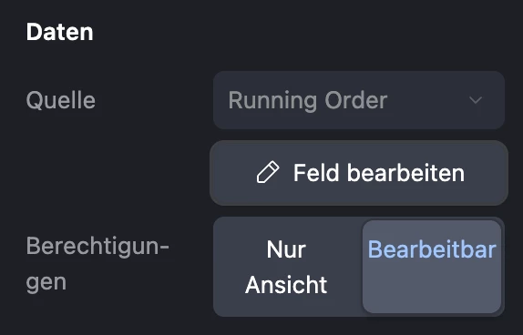

Yes I am talking about the records detail view that appears from the right side of the screen, when clicking in a record. The option that seems to mirrored to both list views is the following.
Because it is in german:
Data
Source → Field Name (Running Order in my case)
🖊️Edit Field
Permissions: View Only / Editable (this is what I mean)
The idea, that it will mirror, when die detail page looks exactly the same in both lists, sounds a bit wild for me, but I will check, if this might be the case and let you know!

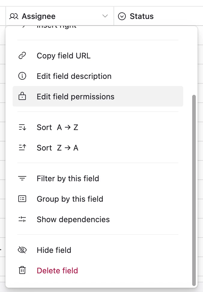

Then you may be changing the Field Permissions at the Data level, which might look like this:
Screen shot of field menu options, which includes “Edit Field Permissions”
If this is the case, then what you actually want to do is leave those permissions alone, and change from the interface editor instead. When you go to the page of the interface you want to edit and select the list data, you should have this option at the bottom of your options menu:

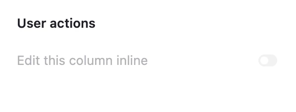

If you toggle the “Edit records inline” option on, your users will be able to edit the data in that particular list page of that particular interface, and only that one. Additionally, if you want them to be able to edit some fields but not others, you can click on the field header and then in the right-side menu, toggle “Edit this column inline” to give that option. You can only change individual fields’ settings if you have the overall list’s settings toggled to “edit inline.”

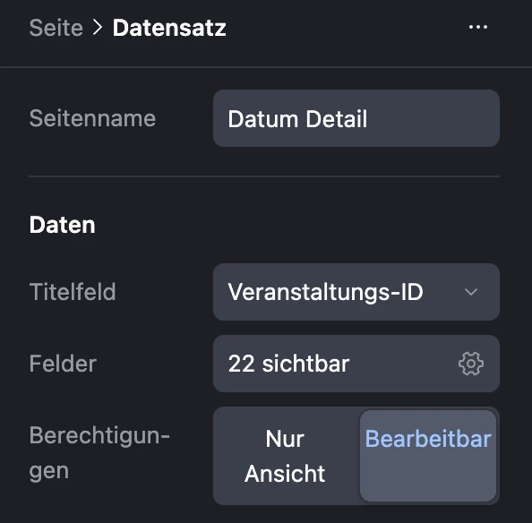

I cannot change permissions of fields. I also thought, that it must be sth global, but it in the detail view it literally says, that I can change permissions for the whole detail view, specific groups within the detail view oder even specific fields within a group.
This when I only opened the detail view and did not select any groups or fields. Here I can change permissions for all 22 visible fields at once. And this mirrors to the other list.
