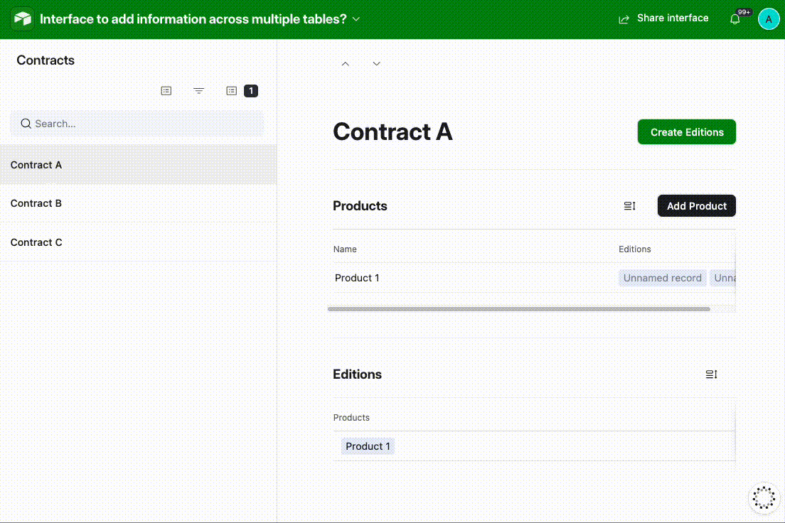

How does this look?  I’ve set it up here for you to check out

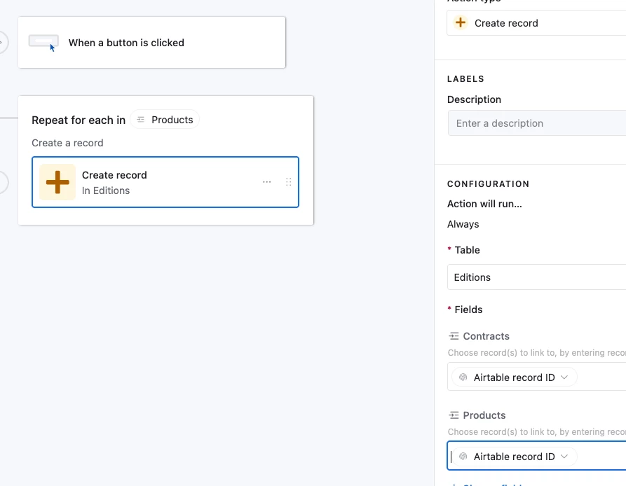

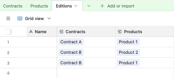

We’re using a Record Review layout that lets us see the linked Products and Editions as views.  The ‘Create Editions’ button triggers an automation that creates one record in Edition per Product that’s linked to the Product, and here’s the end result of that gif:
Automation:
6 replies
Automation:

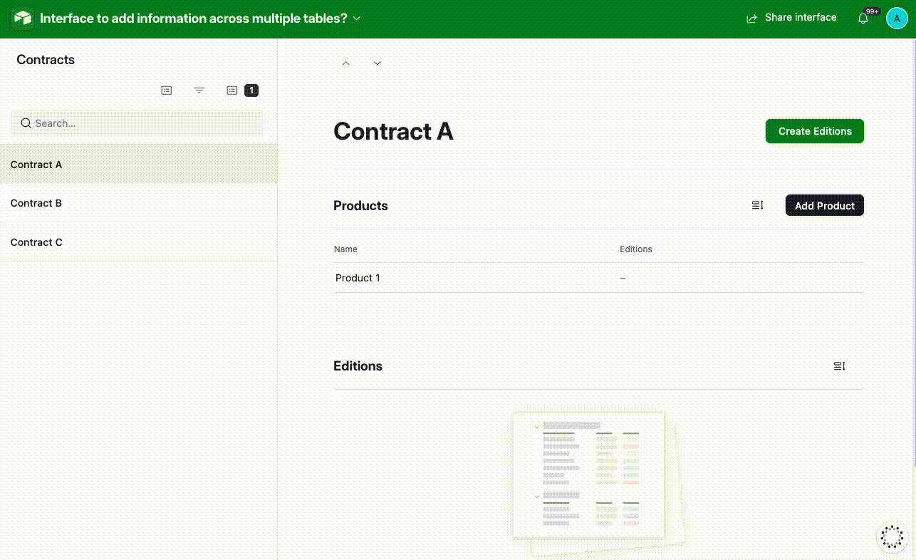

Thanks for this - from that same interface would I then be able to click in and edit the details for each edition or would that require a new interface?
We’d do it within the same Interface, would just need to add a record detail to it and it’d look like this:
And you can find this update in the example base!

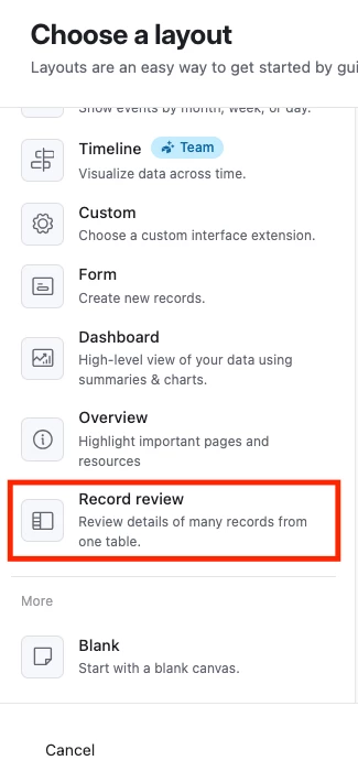

Thanks so much - when you started building this what did you choose from the interface menu? Sorry - I’m VERY new to interfaces.
Ah I used a Record Review layout!
