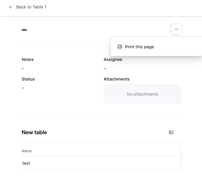

I have an interface - created as a blank interface, and I am using  an existing table to enter the info. How do I go about printing this?
What I really need is a clear place for me to click into a record and see all the info at once - like a PDF (I should be able to design it, very specifically), I should be able to switch between records very easily, and print easily and neatly. Any ideas?

Blank layouts aren’t supported by Airtable for printing I’m afraid, and so you’re reliant on the browser’s printing functionality.  This sometimes doesn’t work as well as one would want though, so maybe you could look into a browser extension that helps with this?
As an alternative, you could try creating a List + Record Detail layout.  You’d be able to select the record you want and the Record Detail is fairly customizable while still being printable:

Unfortunately, comments can’t be printed, but you may want to suggest that as a feature request by using the product update form
