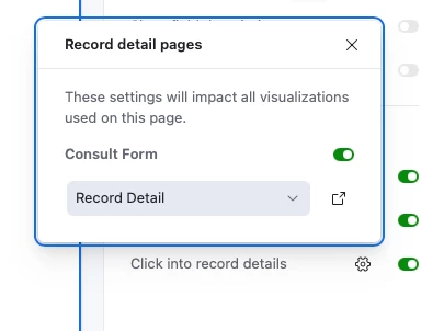

On the List page that you’ve duplicated into the second interface (Interface B, we’ll say): you’ll want to navigate to the Page > List menu. At the bottom you’ll see the “Click into record details” toggle. With the toggle turned on, click on the gear to see this little pop-menu:

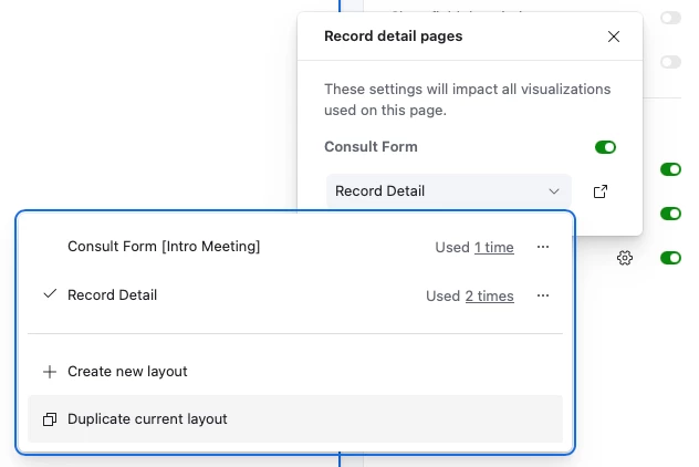

Clicking into the dropdown shows all existing Record Detail layouts. You’ll want to make sure the one you want to replicate and then modify has a checkmark next to it. Once that’s done, just click the Duplicate current layout option:

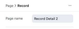

Once you’ve duplicated it, it should automatically open your new, fully distinct record detail page, like so:
I recommend renaming the Page name to something specific (e.g. the original interface’s record detail page name, “with Button”, or “Record Detail - Interface B Version”), just so it’s easier to keep track of the different versions and options as you potentially build more ways to interact with your data.

If I understand the ask correctly, yes, completely doable! You’’ll just need to tinker a bit in the record detail pages menu.
