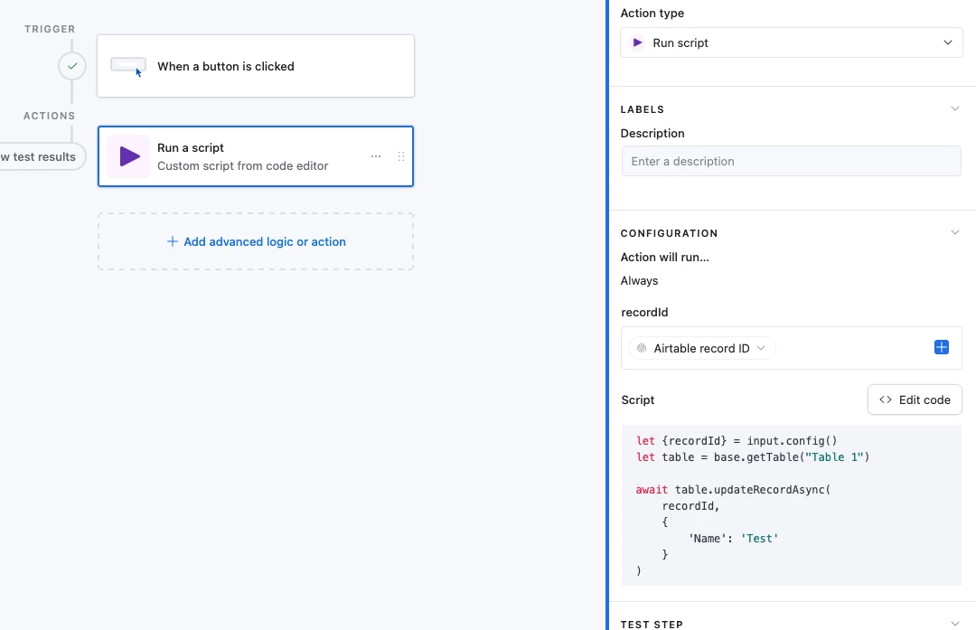

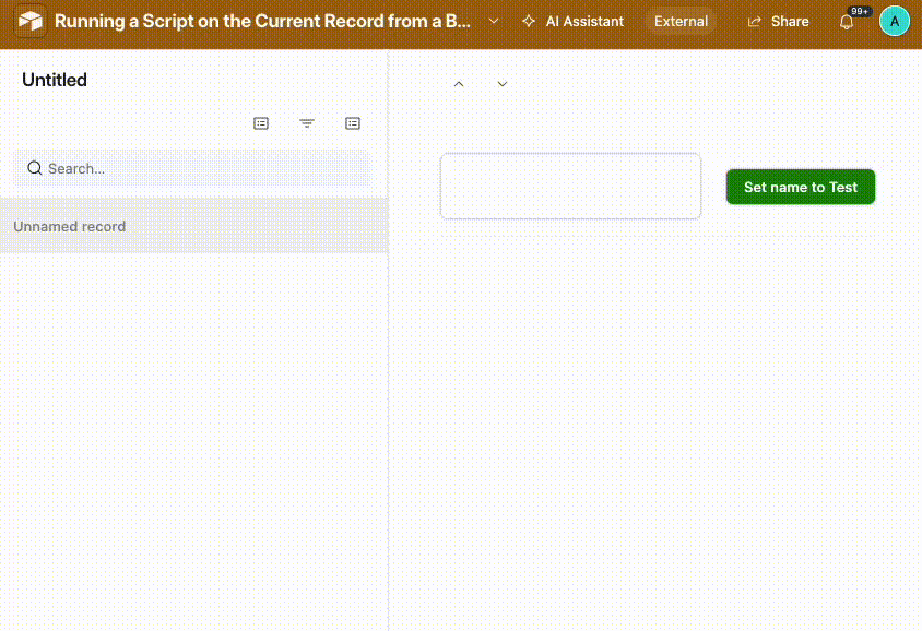

I’ve set something up here for you to check out
On click, the button triggers an automation that uses a script to update this record’s ‘Name’ value to ‘Test’.  To get this to work you’ll need to be in a context where a record is selected, and so a Record Review like above works, or you could use a Record Detail, etc

Button fields can’t run scripts from interfaces. They can only run scripts from the data layer, because they require the scripting extension and extensions can’t yet be installed in interfaces.
Instead, if you want a button to run a script from an interface, then you need to add one of the interface’s button elements to your interface page, and you can trigger an automation that way.
Then, inside your automation, you can run a script and you can pass the triggering record ID using the input.config variables in the left margin of the script editor.
Hope this helps!
