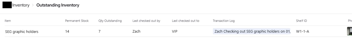

I’ve seen similar questions asked, but I can’t quite find the solution I’m looking for.
I manage a fairly large (~2000 item) equipment inventory. I have a system to check items in and out to different people, projects and locations. Basically, I have a table of inventory items, and a table of in/out transactions that links to the inventory table and includes quantity checked out, destination, program, etc. I also have a form for various users in the company to create a transaction record, and dynamic fields in the inventory table to keep track of how much inventory is available, and how much is checked out and to whom. Screenshots below:
Inventory Table
Transaction Table
Checkout Form
Outstanding Inventory interface view
This is fine for checking out a single inventory item, but it’s rather slow and cumbersome for checking out multiple items at once. Think someone loading a truck with a barcode scanner. I’ve seen Fillout recommended multiple times here and gave that a shot, but wasn’t very happy with the results. I was able to get multiple items checked out on the same form, but it required me to make another linked table of inventory items and quantities and for users to create a new record for every item they were checking out. This was only slightly quicker than submitting the native Airtable form multiple times, but it was much more complex.

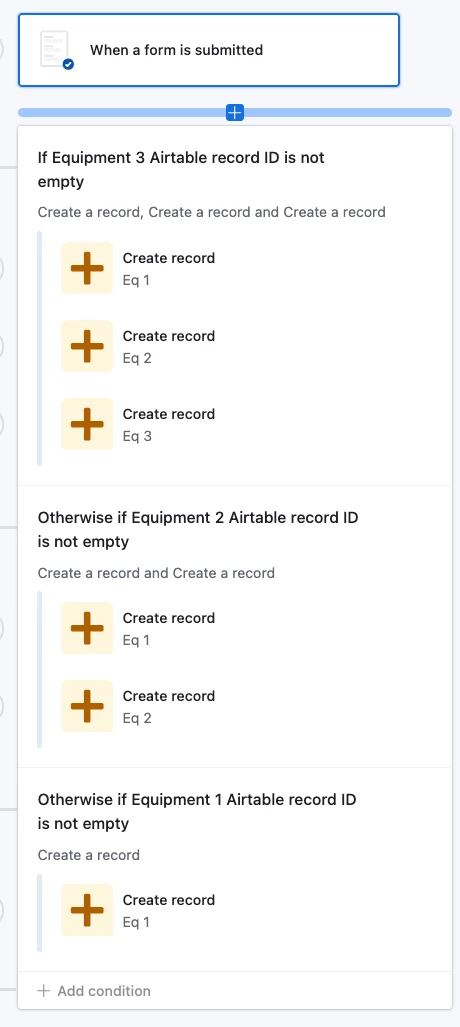

Not ideal, but the last time I faced this issue I ended up creating a bunch of extra linked fields so that the user could key in multiple line items into the same form, and then used an automation to create the records in the Transactions table.  I’ve set it up here for you to check out
The main downside is that there’s a max number of items we can add at one time via the form; up to 6 I believe, based off of the 25 actions per automation limitation.  Other than that it works pretty well for me!
And the automation looks like this

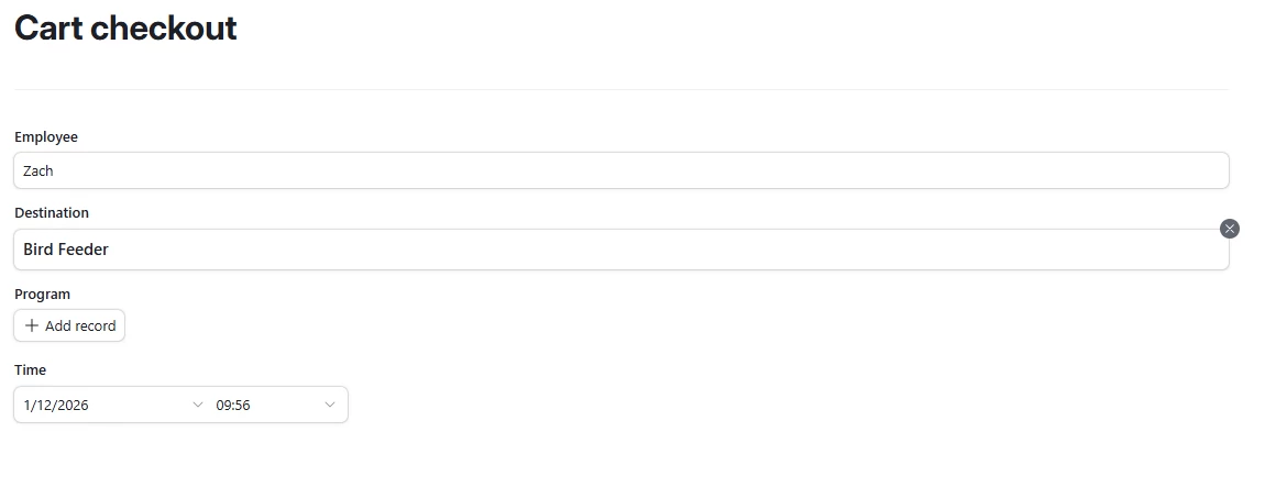

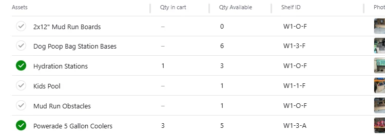

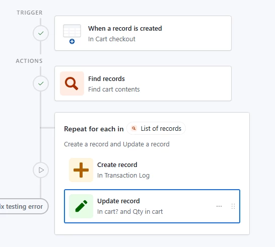

I found a bit of a workaround for checking out lots of things within the interface.
I added a checkmark field to the inventory table for “Add to cart,” and another field for the “Qty in cart.” Then I added another table for cart checkouts with employee, destination, program and time fields, and an interface form to add a record to this table. Adding a record triggers an automation to add a record to the transaction table for every piece of equipment with the “Add to cart” checkbox ticked, and fill in the quantity, employee, destination etc fields appropriately. Finally the cart fields are reset.
So, to check out a ton of items at once, a user would tick the checkbox and fill out the quantity on every item they wanted, then submit a checkout form with their name, the destination and program, and the time.
Inventory selection page
Cart page
Cart checkout page
Automation flow
Corresponding transaction records created by automation
This basically covers all the features I was looking for. However, since it isn’t entirely contained within a form and requires inline editing in the interface, its use is limited to editors/creators. I think we can make this work for now, though it would still be nice to get it all done within a form.
Thanks for the help!

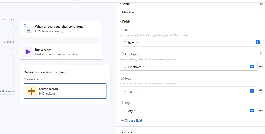

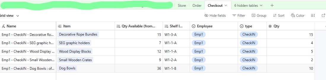

Airtable has a lot of ways to achieve this goal, including AI
When you fill form with employee, type and order,
automation creates checkout records in other table, quantity must be last in line, divided by space or several spaces.
I didn’t use AI, but added a bit scripting
The rest is done by automation
Of course some additional functionality must be added, like checking what if such item not exists in Store list (AI might help with that) , or checking that the quantity should not exceed available in the store. Its just for example.

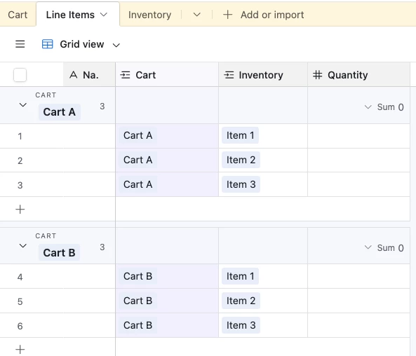

Ah, once we add a new Cart record, the list of items that are created would be only for that Cart
For example:
Jerry creates Cart A.  Automation finds 3 active Inventory items and creates them as Line Items linked to Cart A
Elaine creates Cart B.  Automation finds 3 active Inventory items and creates them as Line Items linked to Cart B
And so you’d end up two sets of Carts that each user could work on at the same time:

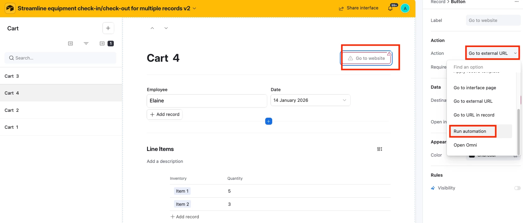

Nope, it’d be in Interfaces and this is how it might look:
And if you want to prepopulate the list of items because checkouts use most of the items in Inventory, you could set up an automation to do that too
Am I correct in thinking that you can't construct interface pages or elements with scripts and automations?
Oh nah, we can totally trigger automations and automations with scripts, depending on the Layout you’re using.  Can’t trigger Script Extensions though
For example, on a Record Review we can add a button to trigger an automation:
For Layouts like Lists, we can either:
  1. Allow the user to click into a Record Detail and then click a button in there
  2. Create a checkbox field or something that’ll then trigger the automation
