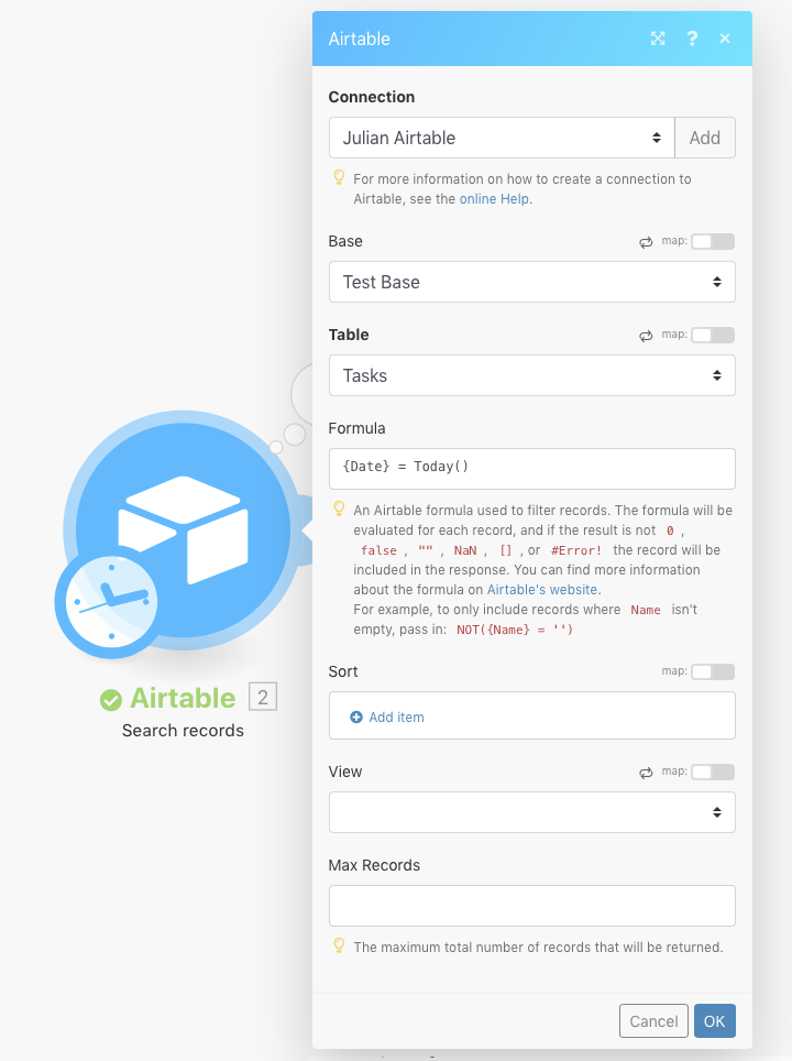

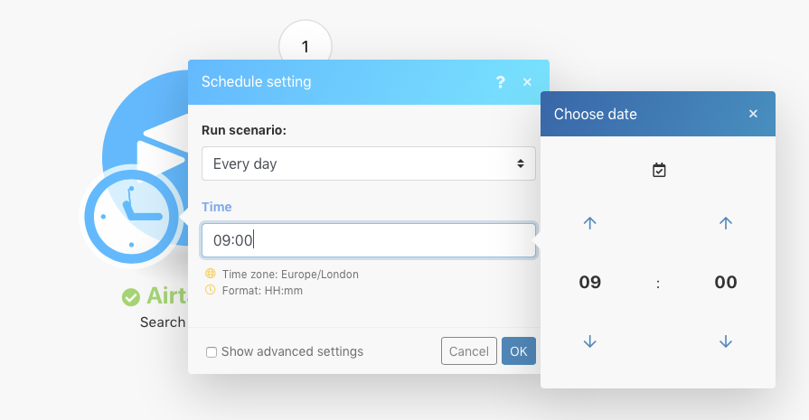

Hi John
I would be happy to help as well - but you may find it easier to do this with Integromat as it is capable of running a process periodically which can search a tasks table based on due date, for example, and then sending reminders. The Airtable setup in Integromat would be:
followed by a step to send the email alert. You could set this to run periodically - for example daily at 9am:
The interesting point about Integromat is that any steps after this search will run for each record returned by the search.
