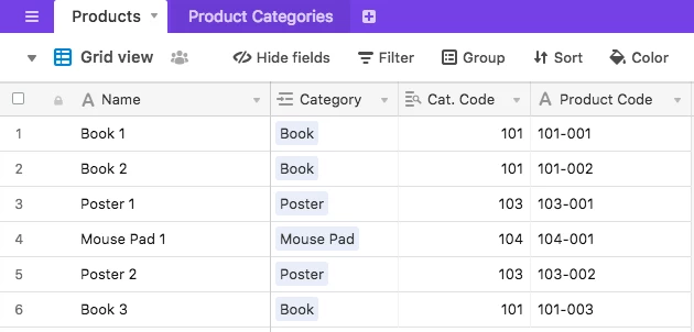

In that case, consider a segmented product code, something like 101-001, where the first part is the base product type, and the second part represents the variation of that product. With three digits in each part, you could have a thousand products (or 900 if you don’t want leading zeroes in your product codes), each with a thousand variations. If that’s not enough options, add more digits to accommodate more products/variations. Obviously this would be cumbersome to track with each product in a new table, but with the help of Zapier or Integromat, the numbering scheme might still be something you could semi-automate. Here’s a quick mockup of what that might look like:
The Product Categories table is the master list of products by category, with an autonumber setup like I described above to give each category its own category code. The Products table is where all of the actual products live. When adding a record for a new product, you would choose its category in the Category field, which then auto-fills the Cat. Code field. Zapier/Integromat would then recognize the new record, count how many products currently exist in that category, and fill the Product Code field in that record with the next variation number in the sequence.
The building of the full code in the Product Code field may also be doable with formulas, though I can’t yet wrap my head around how that would work. Most likely it would require another table and some combination of lookups/rollups/etc. However, the issue I see there is that if you ever re-order your records in the Products table, the formula would likewise re-number the product codes with different variation numbers than they had before. By using an integration service, the Product Code field data is filled once by the service, and would stay unchanged if the record order ever shifts.

I like what you came up with for product codes with category codes. This can be really helpful to gain information about a product from just glancing at the product number. Incredibly helpful if you are pulling stock off of shelves and you don’t want to look it up in the database. Often set length abbreviations are used rather than numbers. So if the length was four the categories might be:
  • POST => poster
  • MSPD => mousepad
  • BOOK => book
The issue with a human readable SKU (Stock-keeping Unit) system is that it takes more work to come up with. It might be useful to have that information. Sometimes it’s easier to just use a simple part number. And I agree with @Xing about random being better. What’s important is that the number is unique. Letting the numbers run sequentially implies that they follow an order. These rules will often break. So even though its extra work removing the ability to make this assumption can be incredibly helpful.
