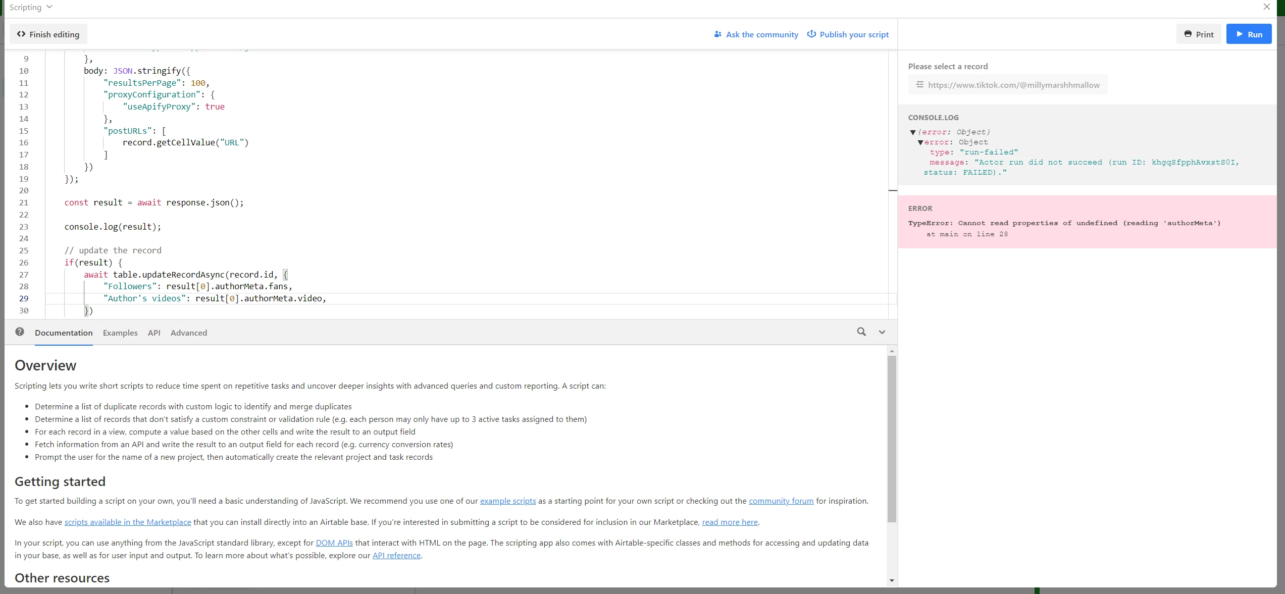

Brilliant video, im failing to make this work with the paid API for 45$ per month.
I activated the trial, and edited the code you provided as I only need followers amount and video upload amount, of course I also edited the actor URL with my own API token '
Run actor synchronously and get dataset items'
Do you perhaps know why this keeps giving me an error?

This just means that authorMeta doesn't exist on the result

I have this under my results, so it should exist, right?

You have to check the result object by console.logging (console.log(result)). That way you'll see what's in that result

Getting the commentCount and diggCount from a video works without issues, what im trying to get is
"fans" and "video" objects.
It keeps giving me the error that it cannot read the objects
Do I need to change something else in the code in order to make it work for Profiel URLs instead of video urls? as I want to get followers and video count and not information from video urls page
