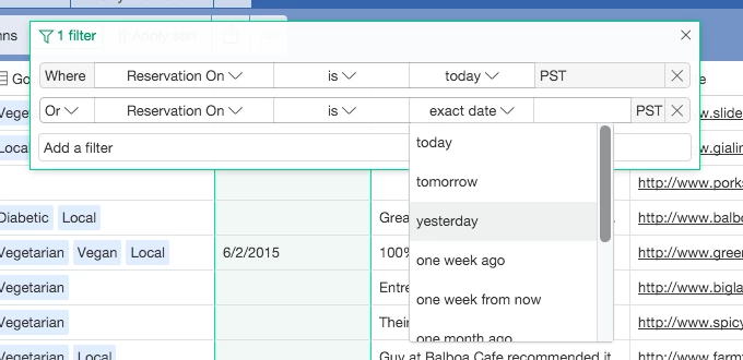

Unfortunately we don’t have modified and created fields yet, but we’re working on them:
https://community.airtable.com/t/date-field-autoupdate-on-last-change-addition/237
Note that if you do have a regular date field, you can filter down to relative dates like “today” and “yesterday”:
But for now you’ll manually have to add today’s date when you create a record in order for this to work.

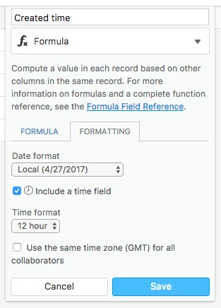

Looping back on this thread:
It’s now possible to configure date formats on formula, rollup, and lookup fields through a formatting tab. Regardless of the format you choose, the field will be treated as a date for filtering and sorting purposes. Enjoy!
