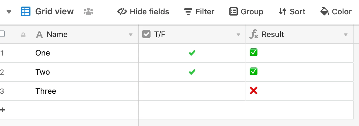

Hi @DanielAssayag - I don’t think you can format it as a functioning checkbox, but you could implement a formula with the “true” value as an emoji:
Formula I’ve used is:
IF({T/F} = TRUE(), “ :white_check_mark: ”, “ :x: ”)

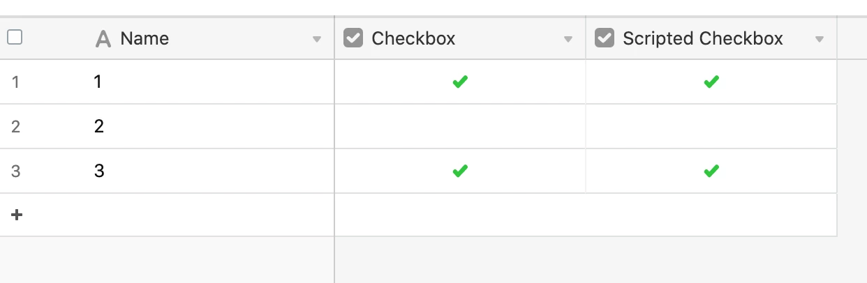

This is a bit of an oldie now and still a good product suggestion. A better workaround than emojis (which was all we had back then) is to use the scripting block to update the second boolean field based on the true/false value of the first boolean field. Something like this would do the trick:
let table = base.getTable('Bool');
let query = await table.selectRecordsAsync();
for (let record of query.records) {
    table.updateRecordAsync(record, {
        'Scripted Checkbox': record.getCellValue('Checkbox')
Still not as automated as a formula of course.

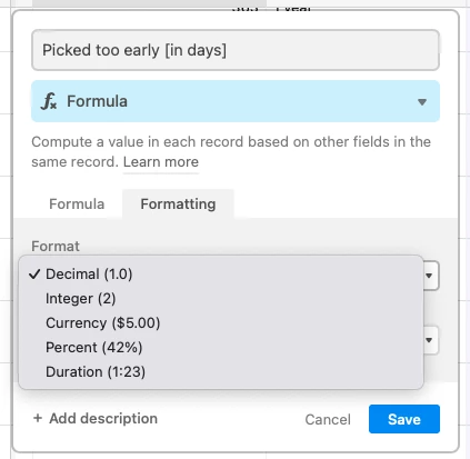

I would also like to echo this feature. This example has only a boolean as outcome, it would be great if we can format the outcome as such:
IF(Field=0, TRUE(), FALSE())
The interface to configure the outcome already exists for other formattable formulas. Here’s the current formatting options for a numeric outcome from a formula field:

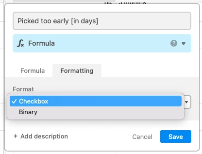

I suggest a similar setting for a boolean outcome:

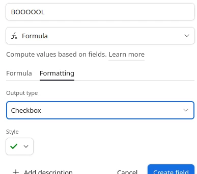

  • November 5, 2024
ZOMG they did it. Thank you, Airtable.
