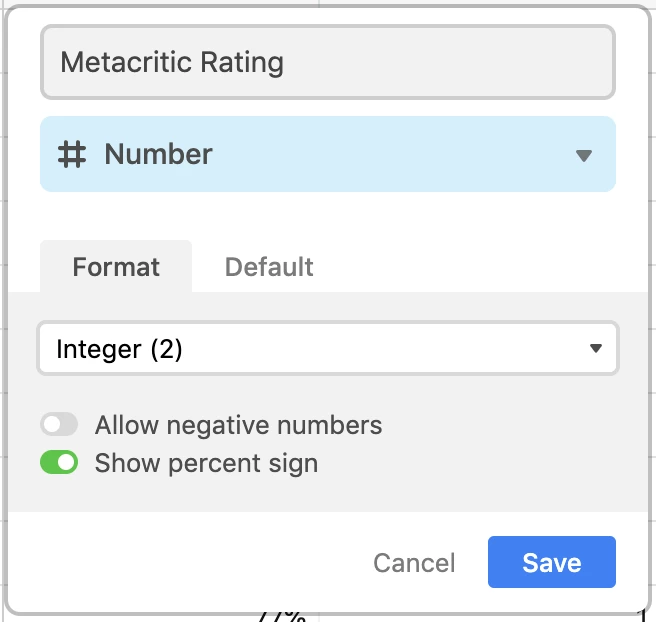

Hi all! Today, we’re releasing a fix to percent field behavior, something that many of you have requested:
  • From now on, the values in all newly created percent fields will be treated as fractions of 100.
  • All percent fields created prior to today have been converted into number fields with a toggle that says “Show percent sign.”

If you are feeling so inclined, you can convert your legacy percent fields (which should now be number fields with a toggled-on “Show percent sign” option) into the new percent fields following these instructions.
