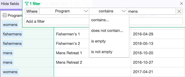

I have {Events} linked to {Program} and if I attempt to filter {Events} based on the {Program} I can’t require it to match exactly, I can only specify “contains” which means “womens”, “fishermens”, and “mens” will ALL be returned if I specify “mens”—so there’s essentially no way to created a Filtered View just showing the events belonging to the “mens” program.

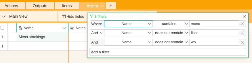

Thanks for the feedback! I’ll pass it onto the team. In the meantime, you can create additional filters with “does not contain” to narrow down your search.
