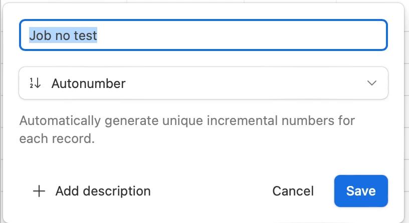

Please can we have an option to choose what number auto-numbering starts at?
Seems like such an obvious feature and was first requested in 2016 and still no sign of it!
I understand I can get around it using custom formulas, but when trying to keep fields as lean as possible this feels unnecessary and clunky.  
A simple 'start number' added to the auto-number field would be great.
