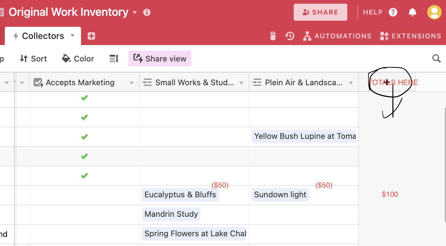

PROBLEM: First, the client record of their art purchase only seems to be in the Artwork Base. When I go to the base with the clients those fields are not synced. How do I make it a two way sync? Second and more important issue: I want to add the totals up across tables in a field in the clients table. I hope that makes sense, I will give an example… Customer Bob buys 2 paintings from different categories. Bob has a Landscape and a Still Life. Each of those is listed in their own table in the artwork base. I want to open Bob’s record and not only see both paintings, I want a field that sums up total sales. Does that make sense? I figured out how to create a roll up table that does this but with only one table. I want it to sum up purchases from different tables.

PS: If you meant adding the $ amounts of all purchases per client, then you’ll need to use a Rollup field for every linked records field and summarize those three rollup fields.

If you want to summarize values, you’ll have to use a Rollup field with a sum function.
It worked! For those interested in the solution: In my Art inventory Base, in the synced table for Clients, I created a roll up field for each table of art type, then created a formula field that SUM the corresponding columns (fields) to give me the clients overall purchase totals. If I open a clients records it not only shows me a link to which paintings they own, but also a quick view of how much they have spent with me in total.
